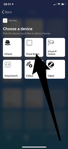

Make a virtual button like below
Make two flows, WHEN virtual button turned on THEN start timer 30 min
Second flow WHEN timer is zero THEN TV off
Put this virtual button in your favourite devices

Hi Marcel, I am just looking to create a virtual button, but I do not see the three virtual devices that you show in the screenshot, only the three communication methods. I am a newby to Homey (just received it this week). Do I need to set some option somewhere or have they been removed since you took the screenshot?
Sorry, just found it in another topic: I had to enable them in settings/ experimental features.
