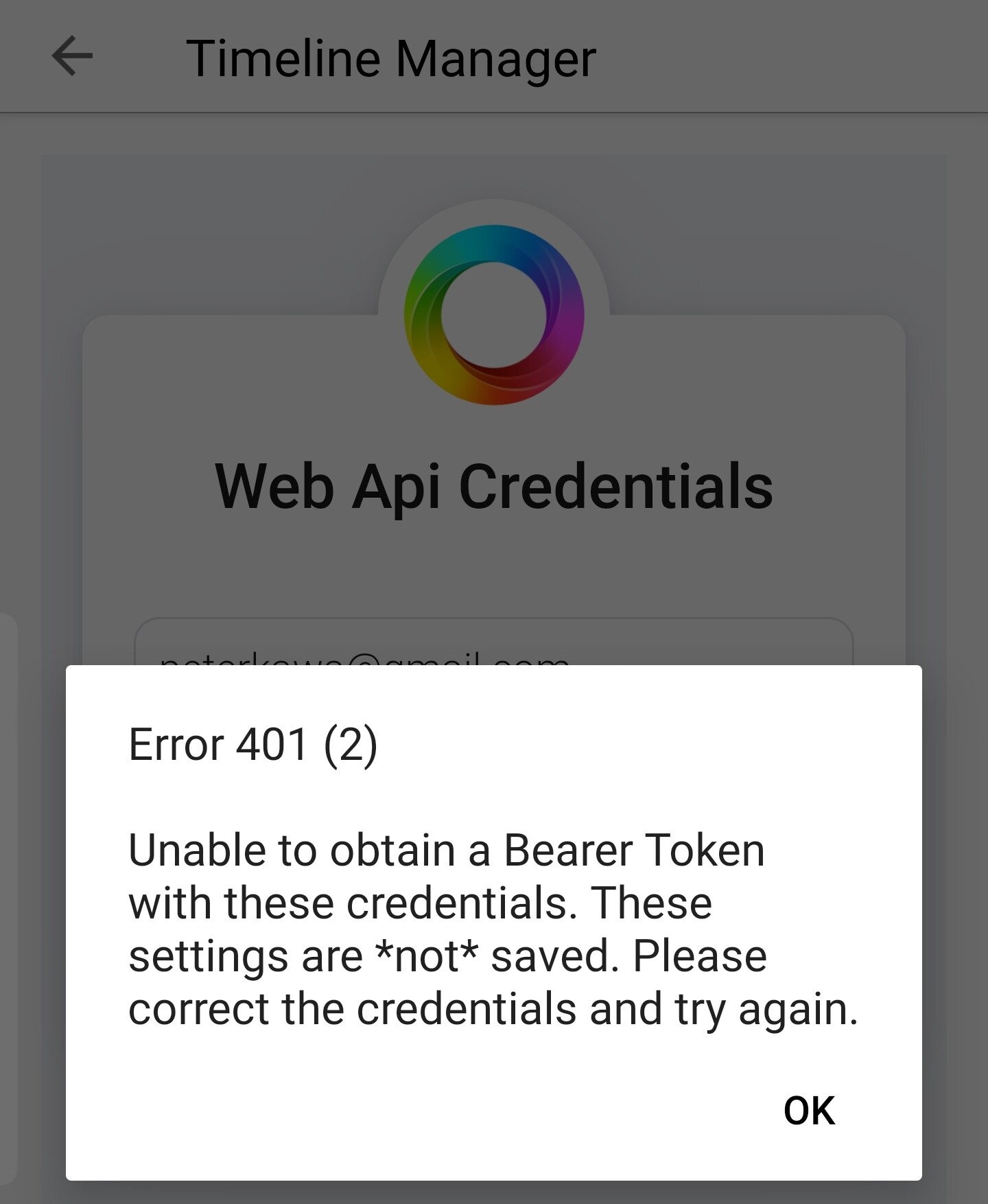

Thanks, I know😁, but I’ve 2FA enabled, and I got an error.
So uneanable itšŸ˜€
Will do
Weird…
Please restart the app and see if that fixes that problem. Does a ā€˜self-deleting-flow’ work?
I’ll have a look at it, although I doubt that I can upload a new build… For now you can only disable 2FA I guess
Thanks,

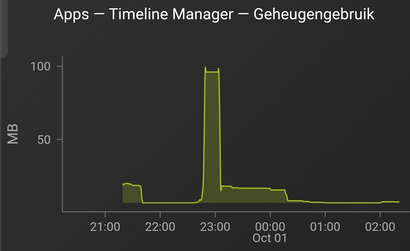

It worked, but Homey got unrespinsive and the Timeline Manager got paused by Homey.
Restarting both Homey app and Timeline app solved it for now.

I’m afraid I made a bit of a design flaw… I don’t ā€˜save’ the token, just hold it in memory. Only the credentials are stored, not the token itself. So every time the app (or Homey) is restarted it needs to obtain a new token, but with 2FA enabled that will fail.
I’ll change that in the next version.
I never experienced Homey becoming unresponsive. I did experience that sometimes the deletion of flows wasn’t shown in the mobile app. After restarting the mobile at they were gone. The webapp does show the deletions immediately; I guess that does a pull, while the mobile app uses a websocket
The flow works
Just fyi,
This probably occurred when running the ā€œremove msgs older than 1 dayā€ flow
