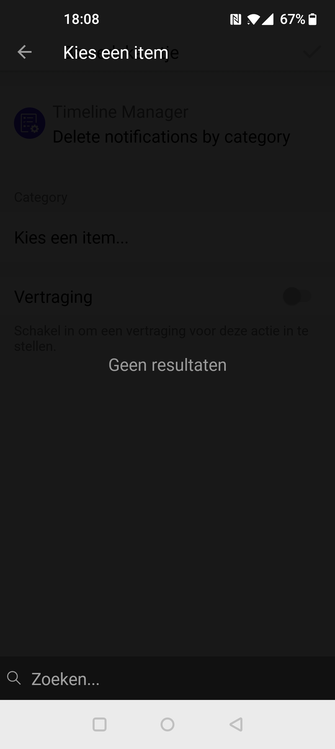

When selecting the ā€œdelete flows by categoryā€ card:
If I hit the white bar below ā€œCategoryā€:
Is this empty at your Homey?

It sure empty although i have more than 6 categories. I never enabled 2FA so yes, still disabled

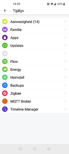

I see a category with no name…?
Me too! Is there for ages. The Icon tells me that it could be System…

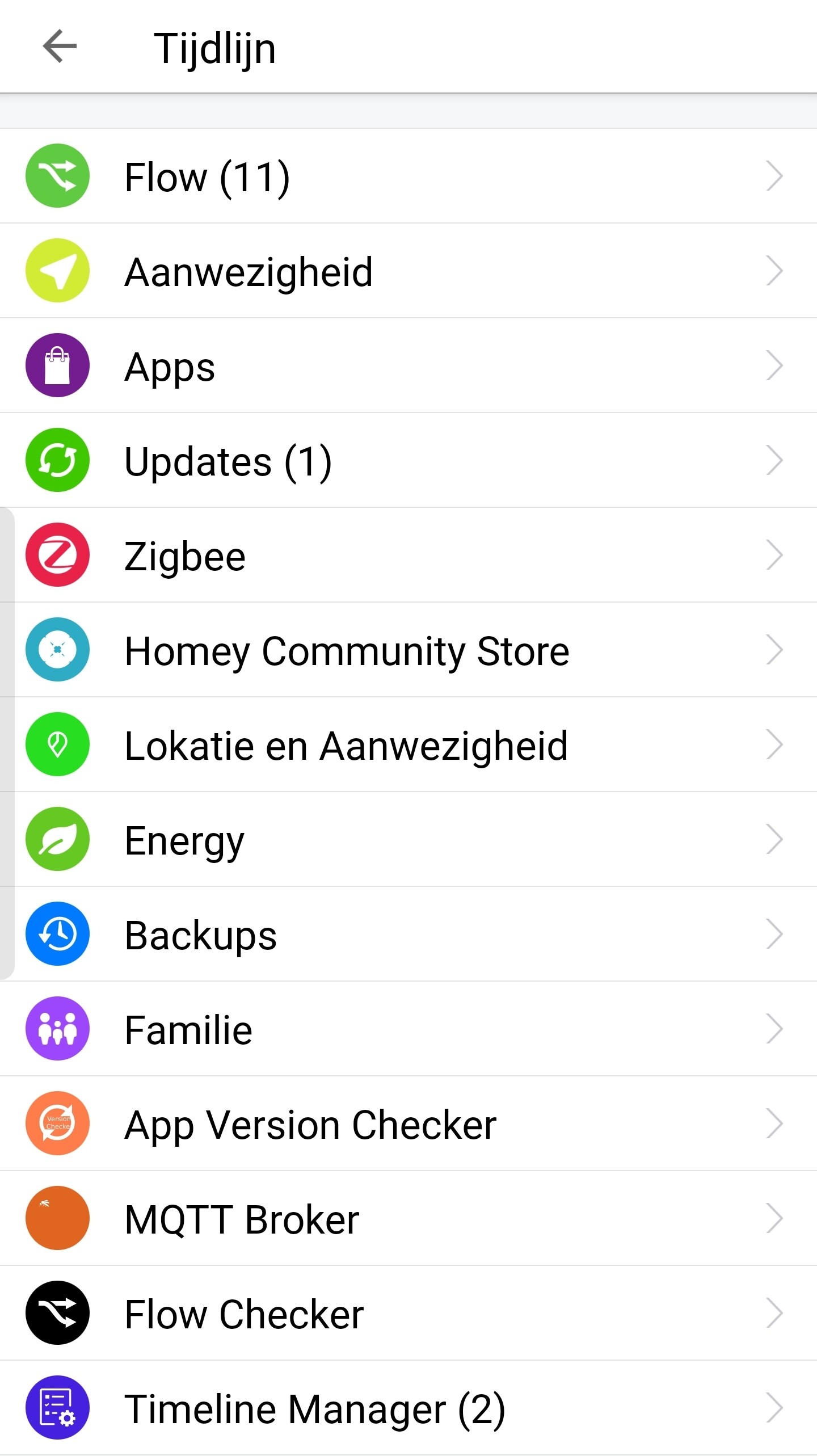

This is my list, to compare.
