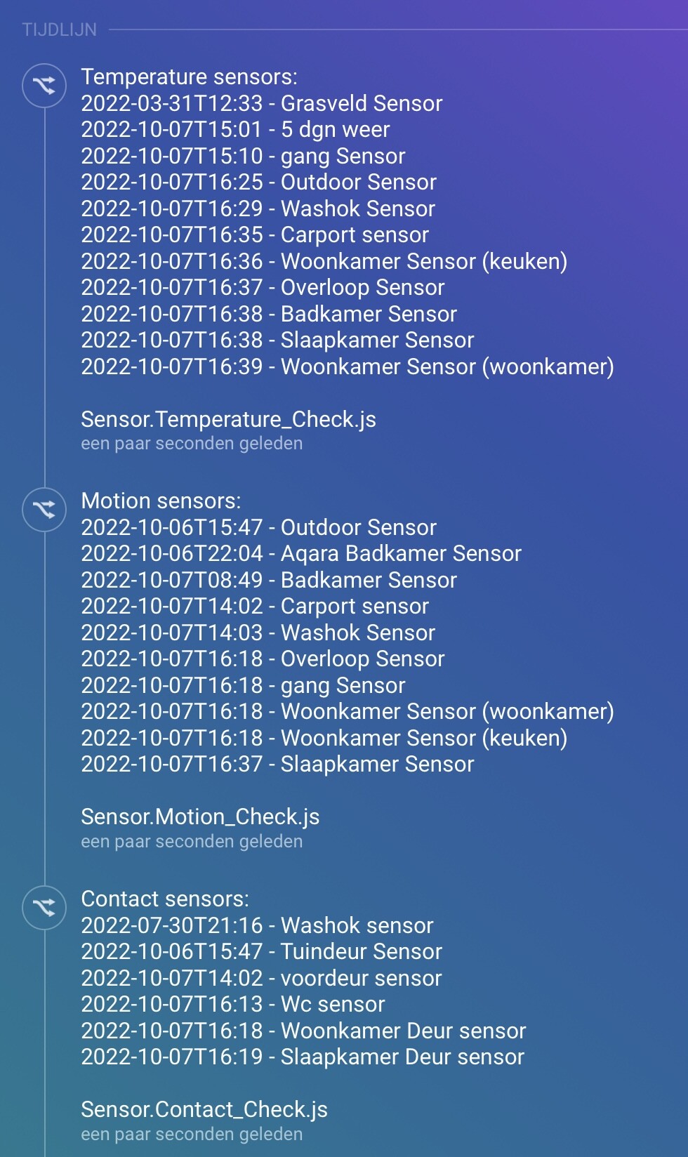

maar dit komt eruit:
zo heeft de hue in de badkamer vandaag wel gewerkt, maar aqara dus niet.
:warning: TypeError: Cannot read properties of undefined (reading ‘lastUpdated’)

Heres the adjusted flow:
[TEF:FLOWS:H4sIAAAAAAACA+1ZW2/bNhT+K4Re4mCmQomkbl13QdaiA9ZtaLsn2wgokrKVypIh0UuDwP99h5LSyIlTKNnSbWgDRLaODs/l47lRvnKMk1w55dZV+fl7XbsbsdG1qUVeNO0DJ3F+t6R3LQn9Ui2d3dSR1doVZgVX+NeXjazzjbnmf2VJbzvSDpiFk8yunByeeGEaKsEyHFLKMYtVgCPCAxyGMfc1ZalkkTNthfz4Er3VZVPVDTpdafke/YBevXJfv0arugEW7SSm3mqwxGr1iCSByiJMqCQYxEgcRTTALPJFEIWK+Wlk+T44CZk6l07iEfisQE1rfrIWpVjqOpF1VYJwa6rJ1/pMfxDSFJdAMpZU50vggjuAZuZIEUaZiHwsqBKYBSnDseYR5or6oYp95inqLFr3r1pxIILECfFaUKLQD3SmY+xRHsJqRrHgcInjSOiAcCZS3pvsUb+zOggOWl1WJs9yKUxelU1vvqy1MPps+Kj3Ajzqbjq79AdLPBW1QrquAe4EnValAS5XWtwTNJnNJDxOEubTUCuqMQ+kj5nwAeWYxhjw9VKqA6VYnCStlMXieIpeV1bTHTFpKDItPA/LIEox83iKI6o5DgWJwjQlHsn8oZh3eg3xJ8y21p2sj5L8mISa+wSHPAZJsQ+SNGMYcFRCKz8UjN5IQghhNHtZVBfoU8G1aLeHBEJSSRXmVCjMlOI4lVGMNfGDjKfcYyTcj6iIdPg2RtTmYTEC+rgKieTcxxyCAuI2zHAaQmBIXzHOQRkj7HY4gA3DcBCbTXI4j7uQ+LncbM2ZsmHRBncBqXwoJCw9cWazjjp22xvIjnK5WIxGeIzY3uOIDR3eGvDjhd1Ui/CoPJo6Y4LOJus+nIfLXAdnvS1PK6XfaAjMsnnbun8bzzYGRm3teAvbPZKgGRSdnPQou33OnrVgT5GpUJsqSHZ01PSbAfelbs1D6SXcrTfCGo4K0Ri03djoQDY6mnk5LwttkKhrcYmeo9nimSXBemBU+s9c6gbI4kLkBrUV3+2p7lKbn7qvkyuU5YWBGoWuJKiA4nLUWXI0RVJsRJoXucm1pYtC1Ouz3t6jHdodg8IzN6vqF0KuJr3waa8bPf8OXc3L1jp3s21Wk/6BOxT7W3ru7sl1rZ9/tG6q791mm3ZhOyFTLzhG36C5AzUCLt9cSyvFWiNrSWvOvDw5qQqlLQQWKUDRVBsE/gyAmne9A+rAetOLmTtT9BAyWlwj3Uo9swq0snC3/jYFcE2OXUueZNuy3c/JjZxrkI7RFZqXqJOU5XVjBrqeo5sbt9kAYBNQPHeOZ8Rudb+q0fCp9pb1yBxYkmeT21q+vSPhGNVtyiDs3bPmu/vXtEv67+RmV6ytVaFdKF1g0el+zCdzYLFbOsTSPa/ycnIEj466fbdM8/JQNrnnDbjY6uniPIMC50L620JnG+ePHf4Qjqj/29Y5RPQnuvTR9IY5V8B7oF8PeUS9hBwZaEDIdu4EPY23N3p2H41ooe6hv082cHQTXyxllPocc0GILcoMalkKBV7JkBJfZL5sy9ifotjaOvZupVFXXBskigaKVwsHEugdxECRlxr9OkAGXeRm9bGkFXljutorq8I2BWdZa23L76B1wPUiV2blQIssiqmz0vlyZa7vbNEG6LUdbVMtZKq1wpJQqMPQRHAKXRoHHtcwb2Tcy7Kh7b9trEmigL2wgCpkrDP7tiFdNPpipWs9tWV321ia5SsqKQpkxBLN3uhmW5jFwI3UKpjutfzxbgjGYQRWGYamCQNMZttJygWOZQZTESUiJcHtgYL7n2WgGDe2PXigGCP21kDBySMHiqeZFEbt2b0jwGBOvjMGDJ49ZhT4rIPAWovG+mBubP7nxoHv3QPiv04FX8BUcCAFHtEr7yTZf3w6eEqv/+6UEEGZox6lOKNwsmaKKxgQCByOWRxEnEWUheHtFkU/T4sa947iwS1q1Blvv0V1Dj/qzDuqIT5NJxu1teMtPNzwuvdLd3rduiX/b068nbljOxxCJye2nvWl/NkDjsCdoq+97gvoda/3UuARBX+YWv/xDvfP+3pvX+u+juxuSmcelV4AJZAJzCTjOOJhikMlhKAsziKyd460qFp/PtVF5s7geHipC1jSHRAfejqMiAoiz9dY0hhOGn4kcUwDhXkkUpZqPw1otvd622f/zg8mXnj9g8mo1Z3JLLr1Tl6Ul9dGjHrtvNjtdovdXwn6gTQcGwAA]
Looks better like this :wink:
