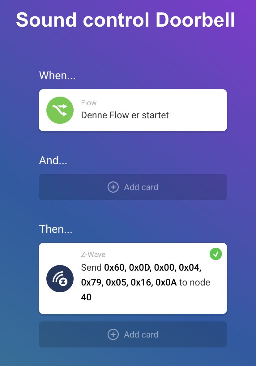

First, thanks for great research and great descriptions on the use of raw commands! But, Im not able to reproduce it. Hope you are able to guide me where I making the error.
(As for your question. I have two buttons and both need to be configured.)
Im adding the flow card:
Then I run it by pressing “Test” in https://flow.homey.app/, it is sendt to my doorbell (node 40 in my network) but nothing happens apart from this log entry.
For other logged entries to Node[40] they seem to have COMMAND_CLASS_SECURITY commands sent prior to the operational commands.
Did you add the device without security? How, if so? Or, what is my misunderstanding?
That flow card should also send the command secure if the device is included secure, so that shouldn’t matter.
But I did include mine unsecure by selecting a device that by default already forces inclusion of unsecure (in my case the Fibaro Walli socket).
Let me try it when included secure.
seems like you are correct that it doesn’t work when included secure :thinking: then it won’t be possible when the doorbell/alarm is included secure, as taking care of the secure part is impossible to do manually, i’ll add this to the main response.
