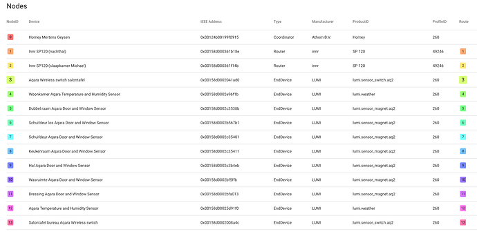

You can check your Zigbee network here: https://developer.athom.com/tools/zigbee
Hi @robertklep ,
Maybe stupid of me, but I see a nice table with all my devices but how can I now see that the extenders work?
Thanks!
The “route” column should reflect the path between each device and (eventually) Homey. I believe that it may take some time before the route is rendered.

I mean it will take a while to render that particular page (few minutes). I don’t have any Zigbee devices connected to my Homey myself so can’t be certain, perhaps other users can shed some light on why the routes are shown the way they are.
OK clear, will leave the page open and see if something will happen, thanks for your quick reply!
Kind regards,
Danny

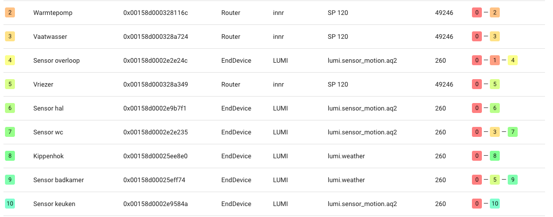

OK I see this now so it seems that the Innr plugs are not extending? Any idea how to fix this?
I had the same problem. I now use some Ikea wallplugs (about 10 euro) and it works fine for me.
You also had INNR lamps that didn’t function as router device properly? Or a meshing problem in general?
I also use the INNR plugs, and they are extending just fine here.
