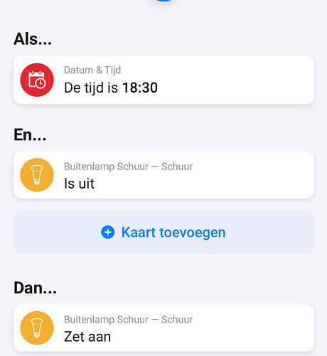

In the flow I can only select devices like light bulbs, etc. I do not have the option to select the hub.
See screenshot from the flow that want to use.
When you remove the power plug from the Hue Bridge, I bet nothing will happen when you test the flow . As far as I know the Homey doesn’t communicate directly with Hue bulbs. So this problem has nothing to do with HomeyPro’s Zigbee antenna or its range.
Although there is an app (I haven’t tried it myself) where you can use the Homey without a Hue Bridge. In that case I guess the Homey communicates directly with the Hue bulbs. Philips Hue, without the bridge App voor Homey | Homey
I suspect in that case all the Hue bulbs need to be transferred to Homey’s Zigbee network and you probably can’t use them with the Hue smartphone app anymore, I’m not sure. With a Hue Bridge they are on the Hue Zigbee network.
When you go to Homey Developer Tools you can see the devices on the Homey Zigbee network. I have many Hue bulbs with a Hue Bridge, and none of them appear in the Homey Zigbee network. It’s all separate.
So your problem must be something else. Maybe first restart the Homey Hue app? Maybe the flow in the Homey doesn’t get triggered properly? Test it by adding phone notifications to steps in the flow. See what notifications you do and which you don’t receive (add a ‘Time’ tag in the notification to see the time the notification was sent). Or create/set variables when a card in a flow runs. Maybe there’s a more direct way (check the log of devices?), but I’m pretty new to this myself and I still use tons of phone notifications to get an understanding of what/when things happen. As far as I know the Homey doesn’t have a very detailed ‘activity log’ that for example I think Home Assistant has.
(Oh, and I think the Hue Bridge isn’t a ‘device’ to Homey. You can’t control it or use it in flows. I think Homey communicates with it via wifi/lan.)
