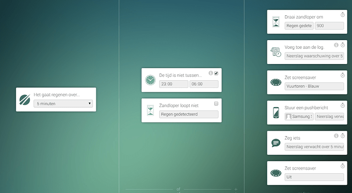

I need help with a flow to notify me only once in 30 minutes. See my flow below.
What happened is im getting notification almost every minute when drizzling.
Please advise.
Thank you

Create a better logic variable,
name it notification or something. Either a boolean or number,
then set the variable to true or as the example below, i increment it 1 time. And the flow will stop once it notify me twice that the ziptrak is closed.
You then need to create another flow to reset the better logic variable when u open the ziptrak for e.g…
Or in your case, every 30mins, set variable to 0 or false…

Found a countdown timer app and this resolved my problem.
Thank you
I also use a counter for counting 15minutes for raindetection by “buienalarm”
Setting the counter when rain is detected
Or if u use the candy app, u can use the card “this flow is ran in the last 30mins”…
much cleaner than the timer Unless u need to trigger an action on timeout…
you can also set a card turn off flow followd by a turn on flow card with a timer on it. I this case the flow turns itself off after doing the jobs and goes back on after 30min waiting. No need for extra apps this way.
