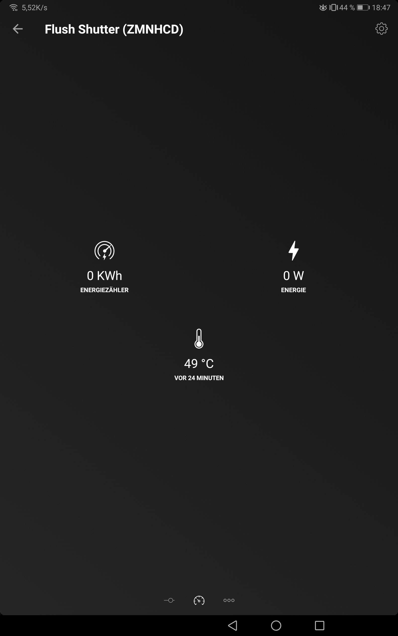

I’m also using this sensor. It didn’t work from the beginning. Always has the same temperature of about 41 degrees…

The sensor is still standing at 49 degrees. It can’t be a hardware issue, because with my homee it worked great.
