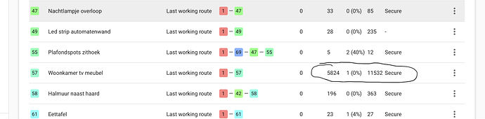

I have about 20 Qubino zmhdd in my home, all working fine but one.
This one often doesn’t respond to commands and upon examination of the developer page I saw extremely high tx and tx counts in comparison to other modules I have. This has been so since I installed my homey about 8 months ago.
I am at the latest homey Version, but still at 2.0.10 beta from Qubino to avoid having to open all wallboxes to reintegrate everything.
Anyone have an idea what this could be?
Kr, Rob

Don’t see ZMNHDD in the mentioned list, but can’t guarantee, updating is your choice. Dit you try the functions under the 3-dots?
