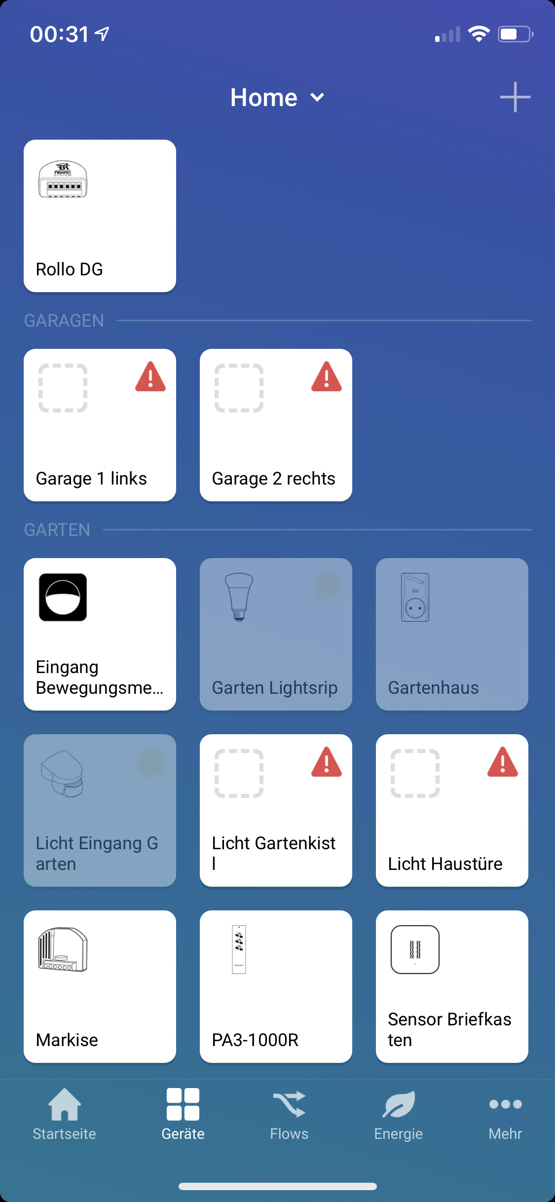

After the Qubino update I can not reach my devices any more. I installed the beta app and included all my devices again, now after the new app was released, all devices are not available any more. Do I need now exclude/ include all devices again?

After updating to 3.0.2, and repairing (delete and add) my ZMNHBD flush 2 relay is not reacting on set on or set out. Homey knows the device, but relay is not reacting.
Any advise?
Solved by deleting and back adding the device, but bring the homey closer to device! (3 meter)
