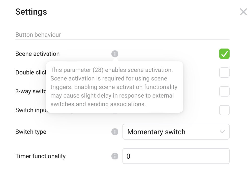

Hi, You need to enable “Scene activation” under advanced settings for the “Dimmer 2”. I hope this resolves your issue.
Hi Awangens,
Thanks for stepping in. Unfortunately this does not help. If this was the case, there would be no reaction from pressing the scene button at all.

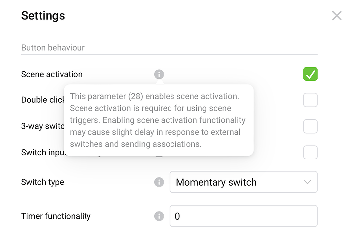

This is what @Awangens meant:
Don’t own a Double Smart Relay nor a Dimmer 2, but with a Walli Switch and Dimmer for example you don’t need to do a raw configuration, because for „Scene activation“ there are advanced parameter:

As I mentioned before, I also don’t own a Dimmer 2. But according the manual it seems to be a bit different to the Smart Relay:
So if you need only the 2 x click (for S1 input), try this these raw configuration datas: 28,1,14
This won’t work, the dimmer 2 can only enable (28,1,1) or disable (28,1,0) the scene activation.
The values you are showing are the values the dimmer 2 sends to Homey on said button presses.
