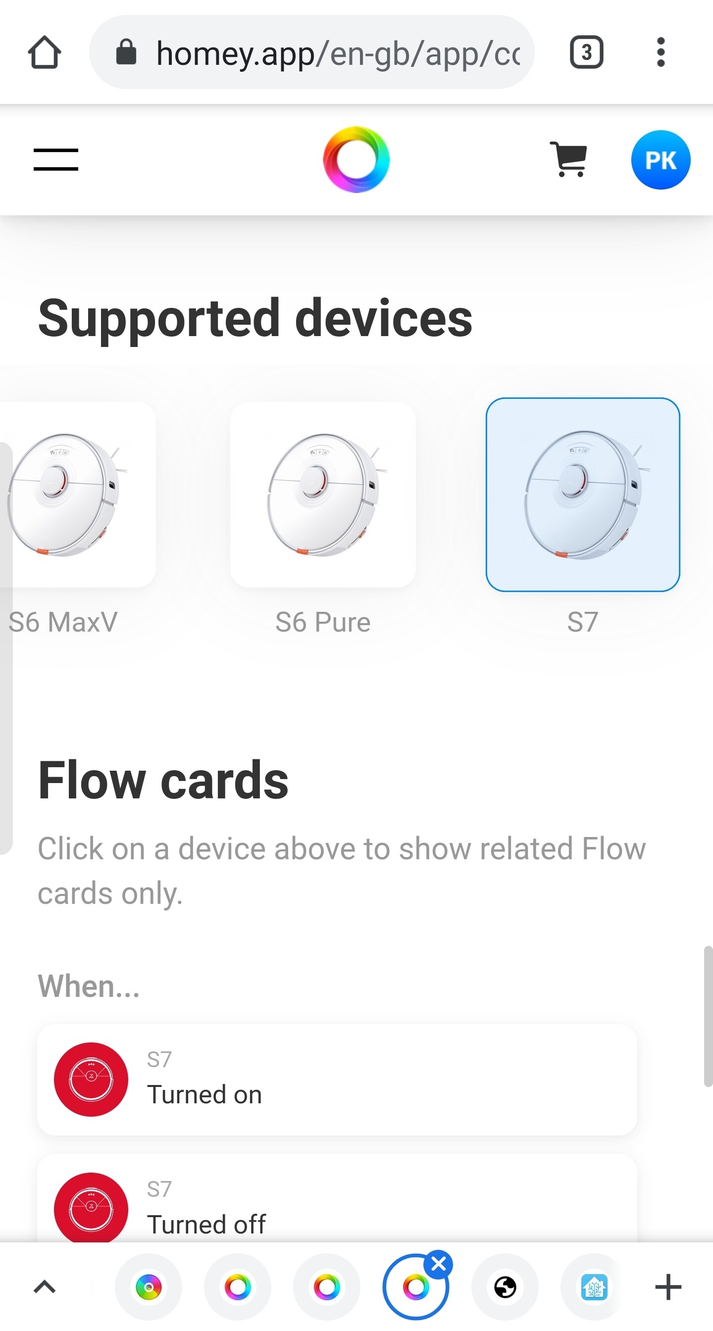

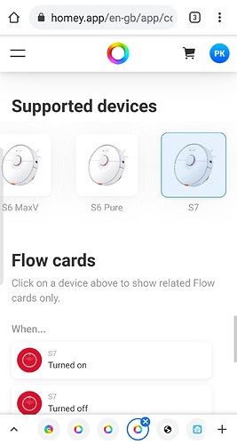

Thanks for the reply, but i want to buy the most expensive type of homey athom pro 2.0 and i want to be sure, that this is working… Ok ill bypass google (its not needed, but is possible to press button on Xiaomi device and tell to roborock s7 Clean SPECIFIC ROOM, kitchen for example (not only start cleaning process of whole appartment) ?
Thanks for your patience DIJKER
You can check it yourself, how cool is that?
At the app page of Roborock (linked to by Dijker in a earlier post), you can select your device, then all flow possibilities are presented for the selected device.
Hi, thank you i saw possibility to clean room in this page. So its possible to push button on xiaomi wireless button and do action on roborock s7 ? is HOMEY that much AWESOME ?
