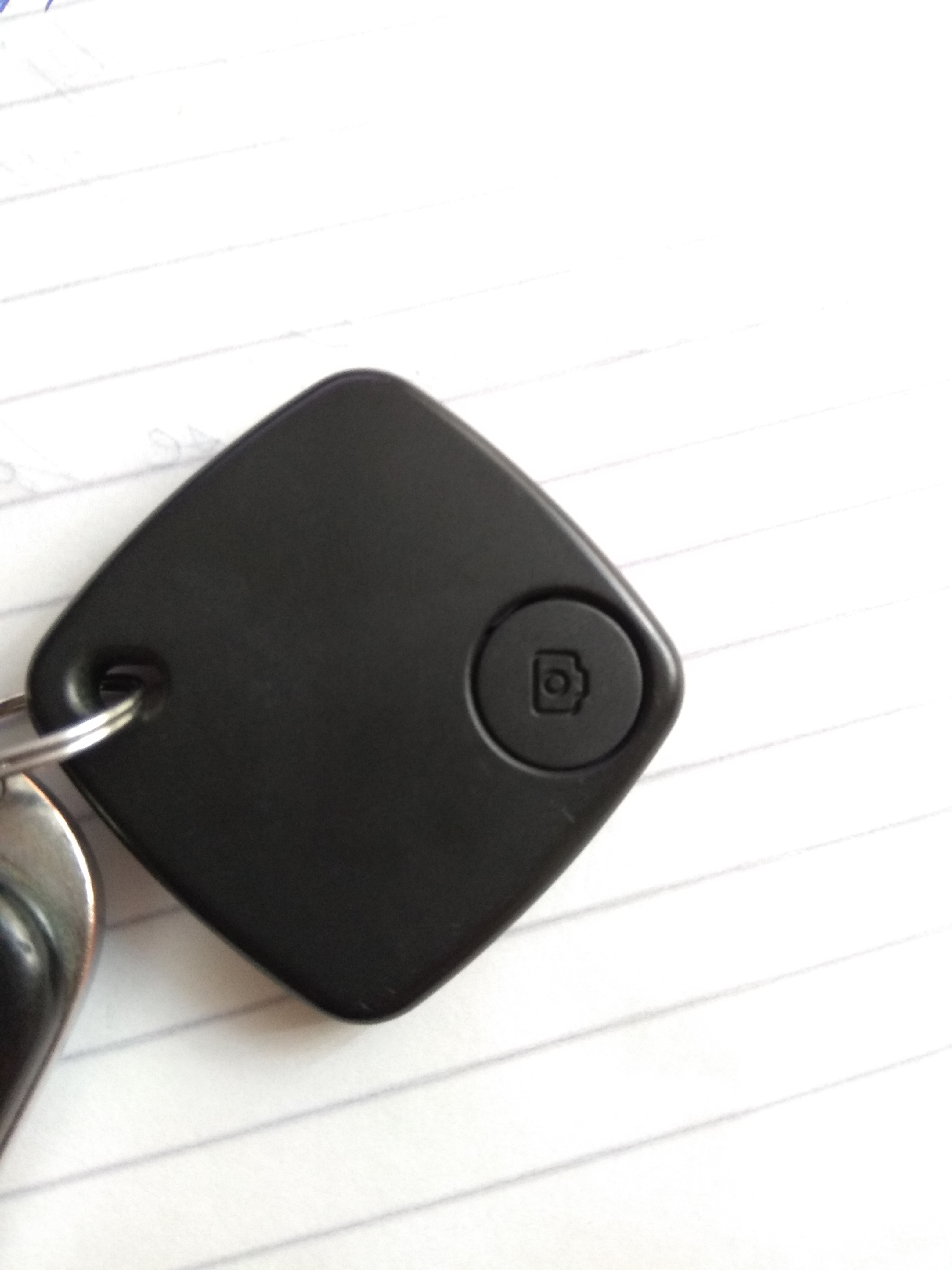

I am curious about the range of these beacons, wouldn’t it go out of range as you walk around the house? or you dont carry the beacon around?
I said i am waiting for it to be delivered and will test it.
Updates?
Hey, after some time for testing the only one out of mentioned (3,39USD) is acceptable. The rest started to be inactive after some time. This one works flawlessly. I increased the number of Homey beacon checking to 20x. I prefer to trigger Away only after certain time and it also helpd to avoid false triggers.

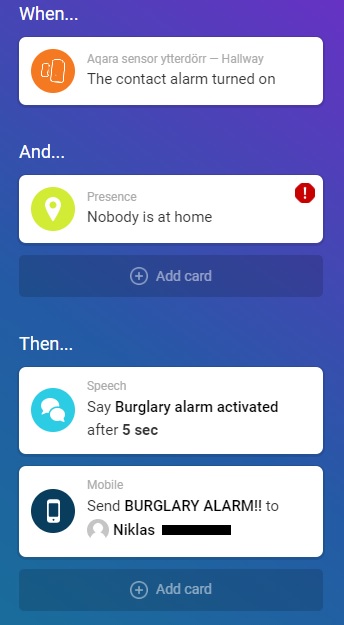

I have a flow that:
When - Front door opens (door sensor)
And - Nobody is at home (presence)
Then - Send push etc
Problem is that when I test it I get an error symbol on the presence card and I can´t understand why.
I have other flows triggering when I leave home and they work as they should.
Any help greatly appreciated.
Thanx Roy, this is the flow as a simple test and as you can see it´s the built in Homey Presence that is getting an error when I use the test function. I have other flows with the built in Homey Prescence cards and they work as they should so I really don´t know why “Nobody is at home” does not.
I was going to try switching the “When” and the “And” to:
  • When “Nobody is at home” - And “The contact alarm turned on” but built in presence does not have that option as a “When card”
No i thought I wouldn´t have to be. Other flows that has presence trigger when I´m leaving home work even though I´m still at home. Is it that those flows have the presence as “when” cards and therefore I can test what is happening as I leave home, but when presence is in a “and” card I need to actually be away from home? Hmm…

The problem I had was not understanding the test flow option completely.
