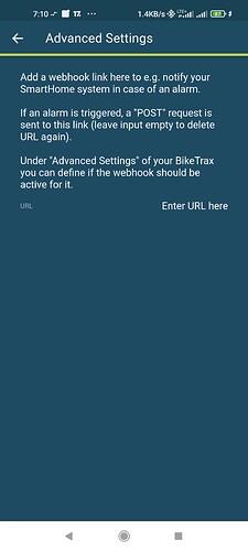

Hi there, please i have a Ebike with Powunity gps tracking. The Powunity allows to send webhooks to a smart home system - see picture. Any one can help me if it’s possible to connect it to homey to receive the webhooks for some flows?

The Logic cards only work with GET requests (Homey doesn’t conform to proper webhook convention), but the screenshot in OP’s post state that the system works with POST requests.

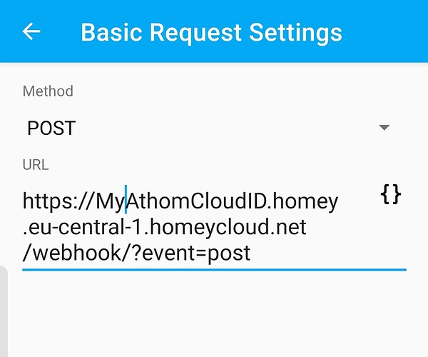

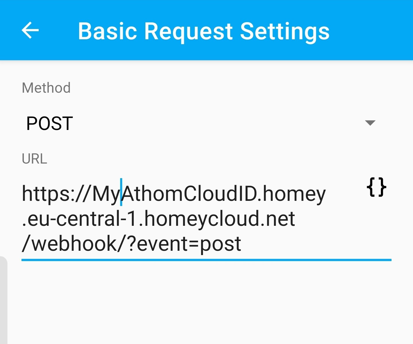

A question, Robert, while I’m no expert here.
Now I have a tool called ‘HTTP Shortcuts’, which can send different types of http requests, with POST amongst them.

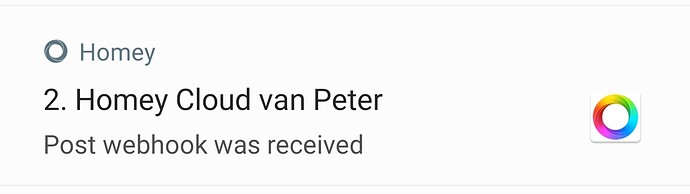

Now this webhook does get processed by Homey cloud:
Any thoughts?
What’s interesting, with Homey Pro it indeed doesn’t work:
… failed with status code 404 (Not Found).
{"code":404,"error":"not_found","error_description":"Not found: POST /api/manager/logic/webhook/post"}
The same URL using GET works as expected.
connect.athom.com is home made by Athom, homeycloud.net is using AWS’s infrastructure, perhaps that’s the difference.

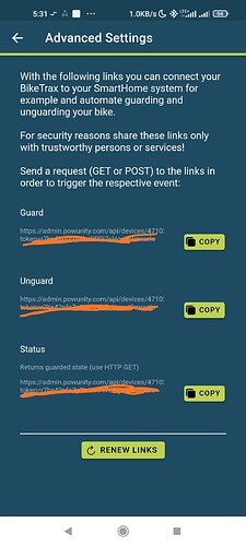

I updated the firmware of the GPS tracking.
Now there appear this.
It seems it works with GET and POST
So what should I now use please?
Use GET I’d say
Hi Peter, the Guard an Unguard works now thank you for help.
