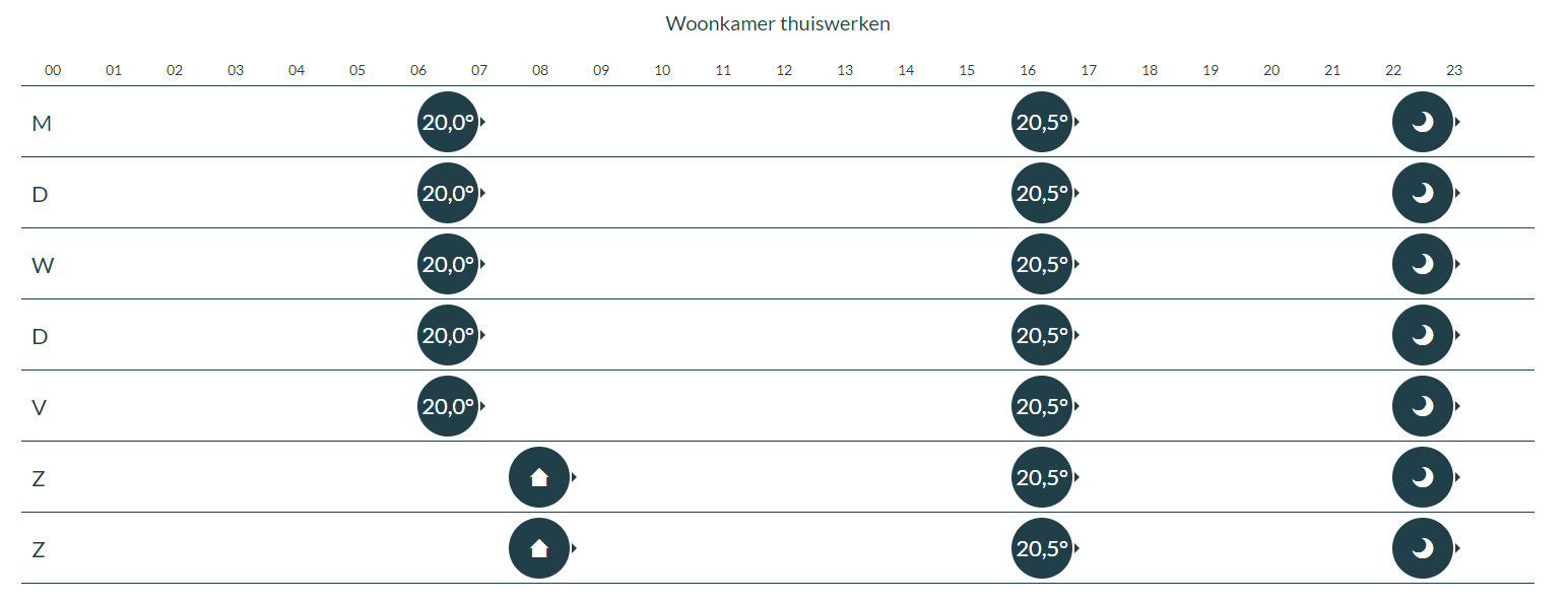

when i leave the home the Adam can switch to ā€œvacation modeā€ thats easy but when i come home i want to have the adam pick up the scheme what is should be at that moment.
example:
when i come home at 17:00 i want to have the heating on a comfortable temperature.
when i come home at 02:00 at night after a good drink i don’t want to have the heating on. (i’ll sleep anyway :P)

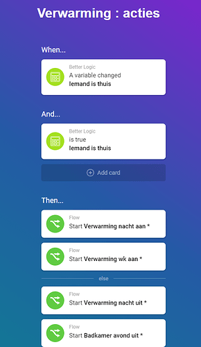

I am not sure what exactly is impossible. I have a similar setup. I manage my presence through better logic. The IF condition is always skipped when you trigger a flow from another flow. So I suppose you need to add a ā€œTime betweenā€ card tot he AND sectiion of the flow. And then use a similar setup to mine.

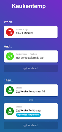

i can’t activate an scheme from the plugwise adam. so what i do is let the homey sync all the non plugwise devices (LC13) to the ā€œingestelde temperatuurā€ that’s the temperature what the Adam/Lisa wants to be.
that works good!
But when i leave home and come home i want to deactivate or activate the plugwise scheme witch can result that when it’s past 22:30 the heating will go in night mode but when i come home at 18:00 the temperature will be set to 20,5°C
get my problem?
