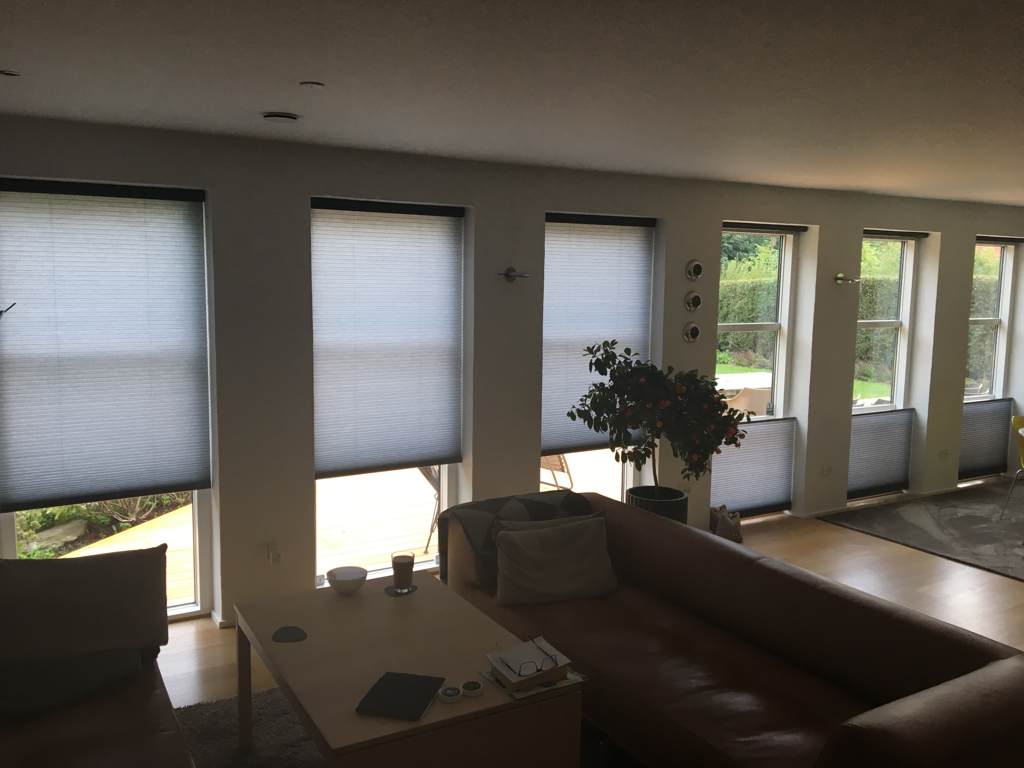

You’ve asked me why I want this to work the way I want it to work. It’s because the position of my garden is S/SE. In the afternoon, the sun goes down which results in more light entering the room. I could close the Luxaflex fully with the first ray of direct light but that would take away the view on the garden form inside the living room. Therefore I would like to lower the luxaflex with the same pace the sun is going down.

Hi - just join this forum. I have the LuxaFlex PowerView top/down Duette curtains based on the PowerView Hub 2.0. I have seen that there is a PowerView App for Homey to control the curtains but not sure what is excatly in this app… What I want to be able to make is a flow that will control my curtains base on sun intensity sensor(s) (e.g. from Hue or Fibaro sensor) e.g. curtains down x% when the light intensity (LUX) is above 10.000 lux for more that y minutes and curtains up when the light intensity is below x-z lux for aa minutes. Reason: to protect the furniture from UV and keep the house cool. If possible I also need the function to control the top down function of the curtains to set winter scenes. Reason: in the winter time our garden is quite open and want to prohibit people to look in while still having natural light into the house. And in the summer to protect our wooden floors where we do not have the expensive leather furniture :wink: (PS: I do not yet have the Homey setup - as I’m looking for a smart home system that can support the above :-)) Cheers, Steen
