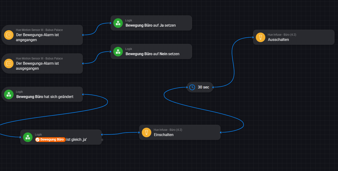

Hello everyone,
I would like the light to turn on when the motion detector is activated. The light should then remain on for 2 minutes. If there is no new movement during this period, the lights should turn off. Otherwise, the timer should restart when movement is detected before it expires. What should the corresponding flow look like? My flow is not working.
Here an alternative that uses the Chronograph app.
  • The first flow turns on the light (if switched off) when motion is detected and initiates/resets a timer of 2 minutes;
  • The second flow triggers when the timer ends and switches off the light (if on).
