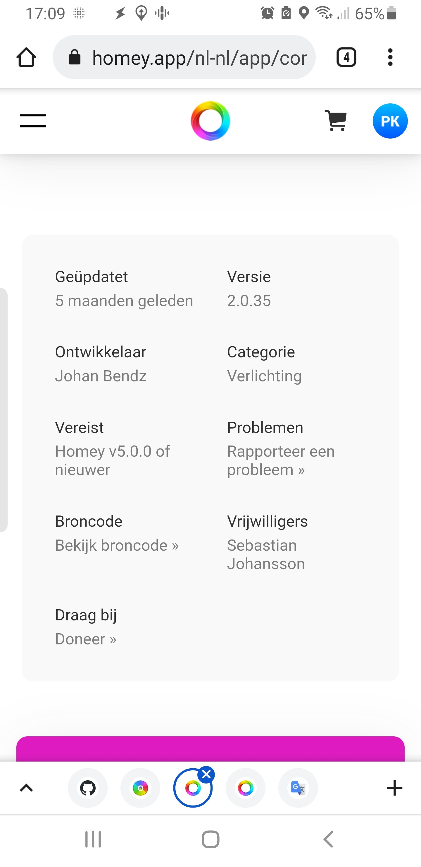

Try the app developer, maybe he/she can find something in the logs by sending the ‘diagnostics report’.
At the bottom of the app page, you can find support and or contact info
