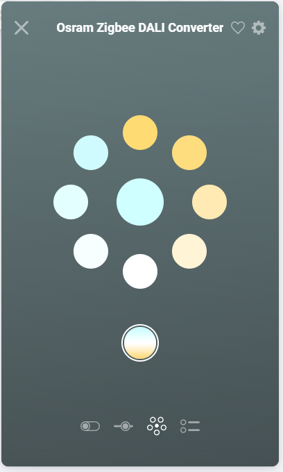

Hi guys,
I was trying to add the Osram Zigbee 3.0 DALI Converter to my Homey. As it was only recognized as an Unknown Zigbee Device and I was hoping to get the Tunable White feature enabled as well I tried to create my own App / Device for my Homey Pro.
I was able to add the device to my Homey and add the onoff and dim capability but I’m looking for the “light_temperature” capability on the cluster but I’m unable to find the correct equivalent.
I’ve currently added the following code to my device.js :

Can anyone help how to implement the light_temperature? I’m totally new to the whole custom app development so a lot of this was scraped by looking at the documentation / forums.
