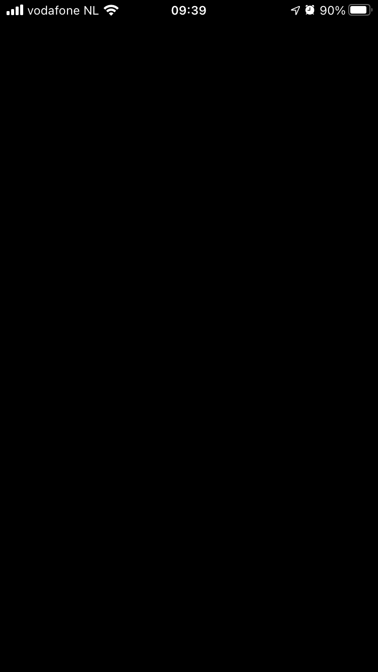

I have some plugs from osram. Now I can’t use it and I can’t delete it. I put the screenshots down below. Hope anyone can help me it’s annoying that I can’t delete it.
