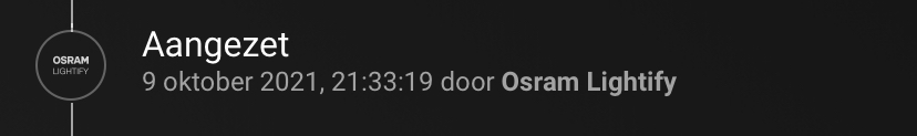

I have the problem that the « Osram lightify » application is activating / deactivating my plugs randomly outside the flows
