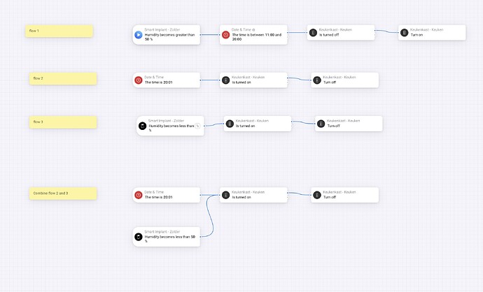

so this should work right?
Yes. You could it even more sophisticated by adding an 3 flow:
WHEN humidity gets less than 50%
AND ventilator is on
THEN switch off ventilator
No, if it’s become lower the 50% then ventilator stopped only on 20:01
If it’s >50% AND it’s 11:00-20:00 THEN ventilator ON. That is the blue line.
On the yellow line bij the 50% cart comes ventilator OFF. Even it’s between 11:00-20:00
Then on 20:01 cart for ventilator OFF.
Look post 12
When the vent has started during day time, you want to stop it as soon as humidity is lower than 50%. And not wait till 20:00. So there shall be a third trigger.
And although it might be possible to combine flows, there is nothing wrong starting with 3 flows. As that is easier to understand for all.
I think we talk about different versions of the flow, as in the last flows posted there is no yellow line.
Post 12 uses another graphical presentations of logic, or has something gone wrong?

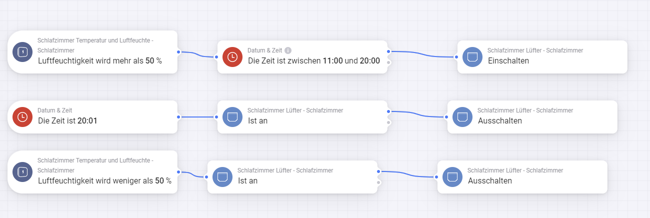

Many thanks, now I changed it. I am not shure if the 50% is absolut or if that mean that the humidity changed with 50%.
