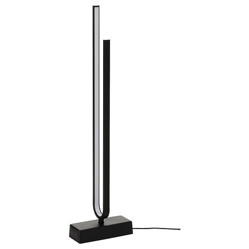

Any ETA for support for the IKEA PILSKOTT floor lamp?
It works as a default device, but it would be nice to have the right icon and all.
