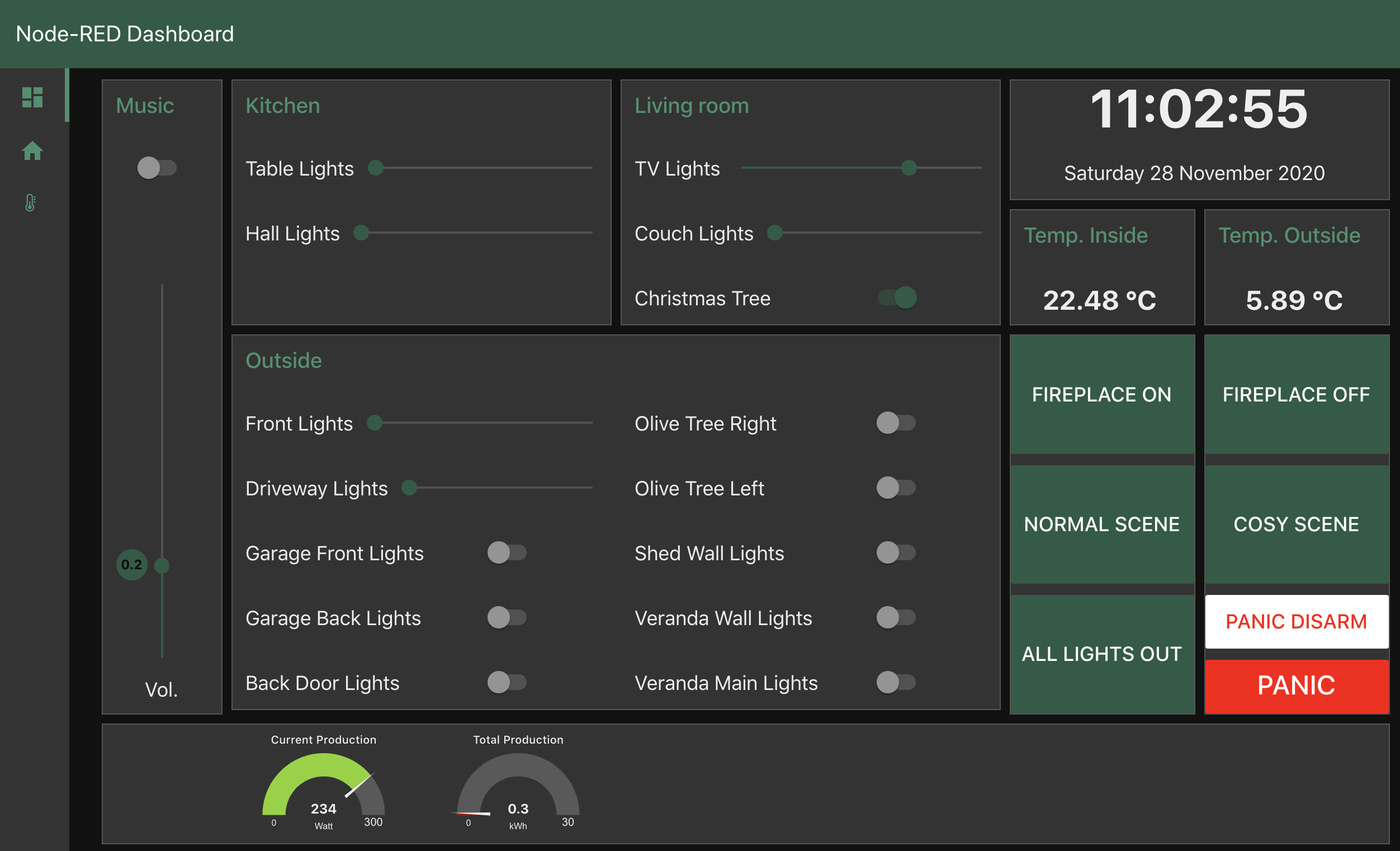

I am no programmer, but would love to have this working. Have spent quite a few hours to get it up and working - but how to get the layout and buttons working as I want seems to be out of my grasp. To be honest I do not want to learn to be good at this - just want to make it work and fulfill my basic demands to help my wifey to easily use our Homey.
So:
Would it be possible to get your full code for your tab (to import to my own Node-RED) - so I can change to my values and connection and learn from what you have done as I go? It is more or less exacly how I want my layout to be and I ask politely and respect your choice if not to. But it would help me a lot! :wink: Thank you and have a great evening/day! :slight_smile:
@Satoer Thank you for this manual. I have never ever did anything with programming but I still manage to come up with some kind of a dashboard.
Still need to add some weather items
@Joost_van_Liempt I would also like to have the traffic map on my dashboard. Can you please share the code you have used?
