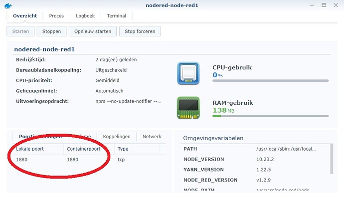

First of all: I’m a newbee with MQTT, so don’t shoot me when i do or ask the things not in the correct way :sweat_smile: (i’m learning).
My situation:
I have a Synology NAS with Node-Red installed (in Docker). I played a little bit around with the “Buienradar” and it is working OK. So far so good.
I installed, in Node-Red, node-red-contrib-mqtt-broker (I noticed, Node-Red is using port 1880 instead of 1883).
To see if everything is working ok, i installed MQTT Explorer (also port 1880 selected) on my laptop. I cannot connect to node-red-contrib-mqtt-broker. MQTT Explorer tells me , the client is offline.
Switched off the NAS firewall to see if the firewall is blocking ports, but no result.
As test I removed the node-red-contrib-mqtt-broker from Node-Red and installed MQTT Client, Hub and Broker on my Homey. Configured them as mentioned in the app’s.
And i can connect directly without any problem.

1 - Any idea what can be wrong with connecting to the NAS? Frontend an Backend are reachable via HTTP port 1880

Did you adjust the docker of nodered to allow the 1880 port to outside? Normally you use the docker bridge as network and need to add the additional port forwarding.
I have installed mosquitto also as docker, so that on the homey I dont need the broker.
In case of errors in the hub, then it could be a permissions problem.
On my synology i have nodered, influxdb, mqtt and grafana as dockers running.
I was assuming these ports were open
