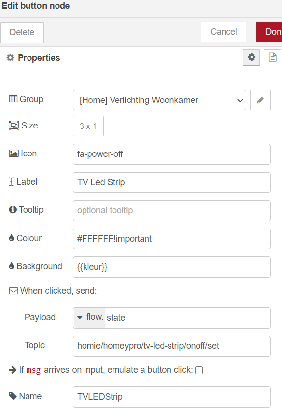

Hi @Kalle_Ektorne,
I am using 4 elements to make buttons work with lights:
  1. an MQTT In node, connected to my MQTT broker to receive messages
  2. a Switch node to filter for the topic (so not payload) of my light, for example the topic: homie/homeypro/tv-led-strip/onoff
  3. the button sends to the set topic of my light: homie/homeypro/tv-led-strip/onoff/set (did you see that the topic is similar but not the same?)
  4. an MQTT Out node, also connected to the broker to send messages
Note that in item ad 2) and ad 3) the topics must be aligned, otherwise the flows will not work
Note also that by default, a switch node looks for specific payload and you should change the filter from payload to topic.
Picture of my switch config:
Picture of my button config:

    "type": "ui_button",
    "z": "9235bbe0.d90a78",
    "name": "TVLEDStrip",
    "group": "e460e8a.9aac518",
    "order": 1,
    "width": 3,
    "height": 1,
    "passthru": false,
    "label": "TV Led Strip",
    "tooltip": "",
    "color": "#FFFFFF!important",
    "bgcolor": "{{kleur}}",
    "icon": "fa-power-off",
    "payload": "state",
    "payloadType": "flow",
    "topic": "homie/homeypro/tv-led-strip/onoff/set",
    "x": 711,
    "y": 1080,
    "wires": [
            "3d0e4074.ce98e"
    "name": "bewegingsautomaat lamp hal beneden",
    "group": "56f5946b.feb13c",
    "order": 2,
    "width": 3,
    "height": 1,
    "passthru": false,
    "label": "Autom. Lamp Hal ",
    "tooltip": "",
    "icon": "fa-magic",
    "payload": "state",
    "topic": "homie/homeypro/autocontrol-lights-ground-floor/onoff/set",
    "x": 791,
    "y": 1600,
    "wires": [
            "3d0e4074.ce98e"

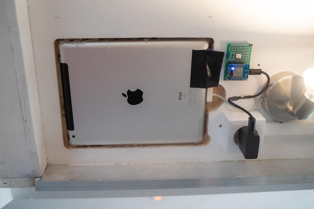

That first screenshot of the ipad on the wall is that your installation? What frame did you use?
Nice extended tutorial / blog btw
Thanks. It’s just some aluminium corner extrusion I cut together. The wall is actually a large hatch see:
