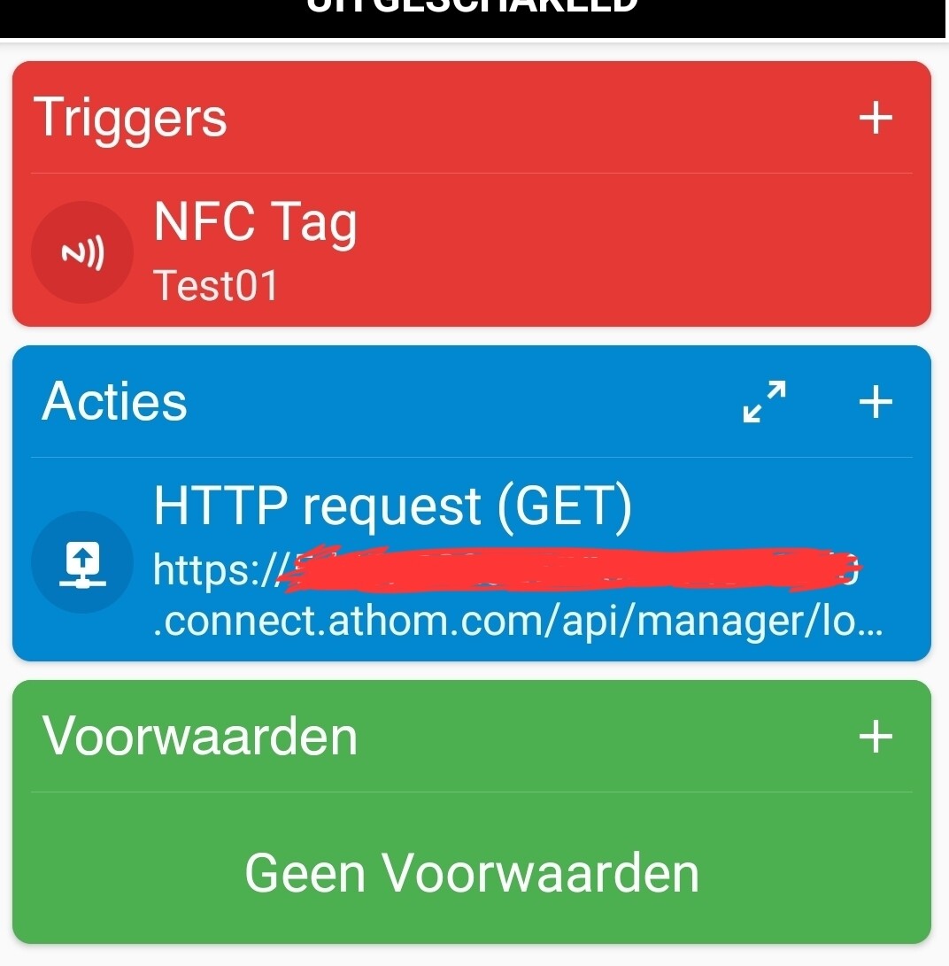

First you make a new makro.
Give it a name

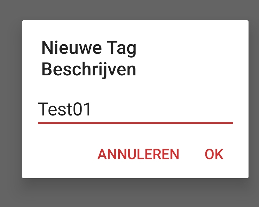

In the trigger field search for nfc.
Then make a name for the nfc trigger. Then scan the nfc.

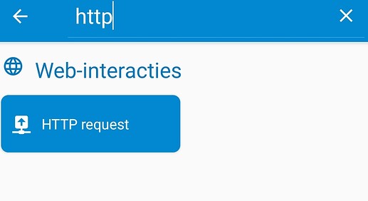

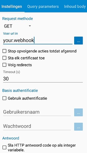

Then go to Actions, search for http, choose that one.
Add here your webhook.
Save the macro and you are ready.
I hope this will work for you and that I have not missed a step.
