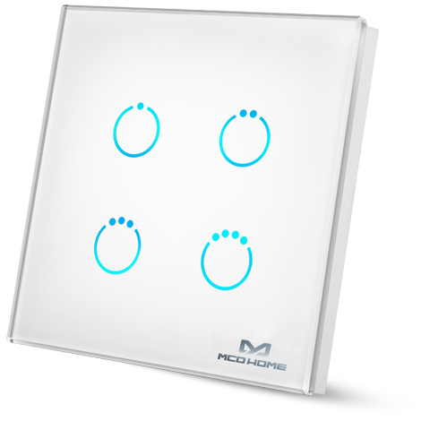

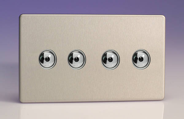

Also, side question - anyone come across a quad momentary switch setup on a single panel (similar to the MCO Home / glass panel switches) that i could use for this? Only ones i seem to find take up a double box which is going to mean a lot of switch space on the wall!!
I assume Fibaro Walli switch would do what you need
Aeotec has the wallmote quad, battery powered, nothing too build into needed.
I actually want them to be wired in - it’s for the primary light switch…
So looking for something like this:
But in this configuration:
(could also look like this if it can wire into the dimmers and act as momentary!

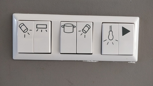

For my setup below, I control 5 lights with 3 dimmers behind the buttons. 3 wired to S1, 2 associated on S2 (dimmer at another location not hardwired) and the 3rd S2 is my scene controller, which switches the lights with Homey based on a flow (single press enables the scene for the time of the day) and double press turns of everything in the room.
Basically, all 5 lights will still work if homey is down. Then only the scene control button would not work.
