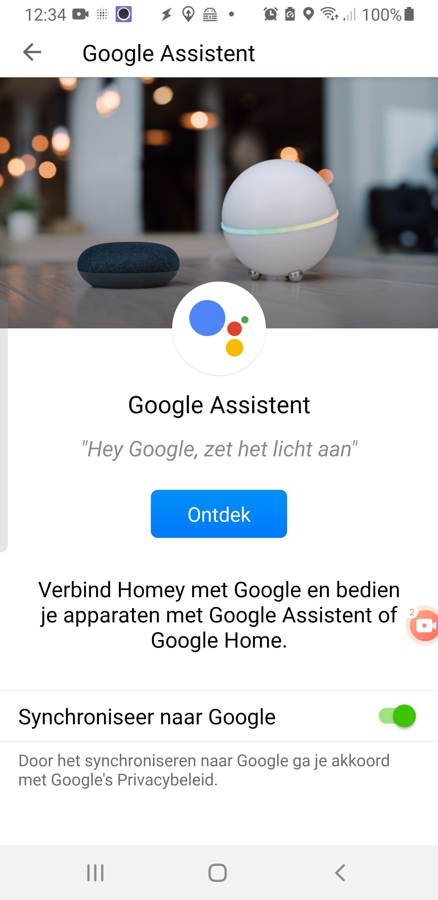

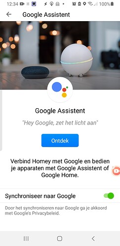

I’m new to homey and just started using it. So far everything seems to work great and I can control all the divices I want.
I use the Google assistent for speech. First I made three flows in Homey. I made a few “routines” in Google home app with a voice command as starter and a Homey Flow (that appears as “scene” in the Home app) as action. This went well.
The problem: after the above, I made a few more flows in Homey. But whatever I do, the new flows don’t appear in de Home app! The only thing I see under the scenes are the first three flows I created, and 4 generic ones (good morning, good night, at home, away) that I can’t find anywhere else in the Homey app or the Google home app.
Does someone know what is going on here?
PS. I translated the names as good as I could, but they are in Dutch.
Oh, I tried:
Rebooting the apps and my phone
Clearing cache
Renaming the flows
Putting the flows in folders
Asking Google “sync my devices”
Also, when I edit the 3 flows that Do show up in the home app, the name of the flows (scenes) changes almost immediately, so it IS syncing with Homey. It just doesn’t show anything new I create.
