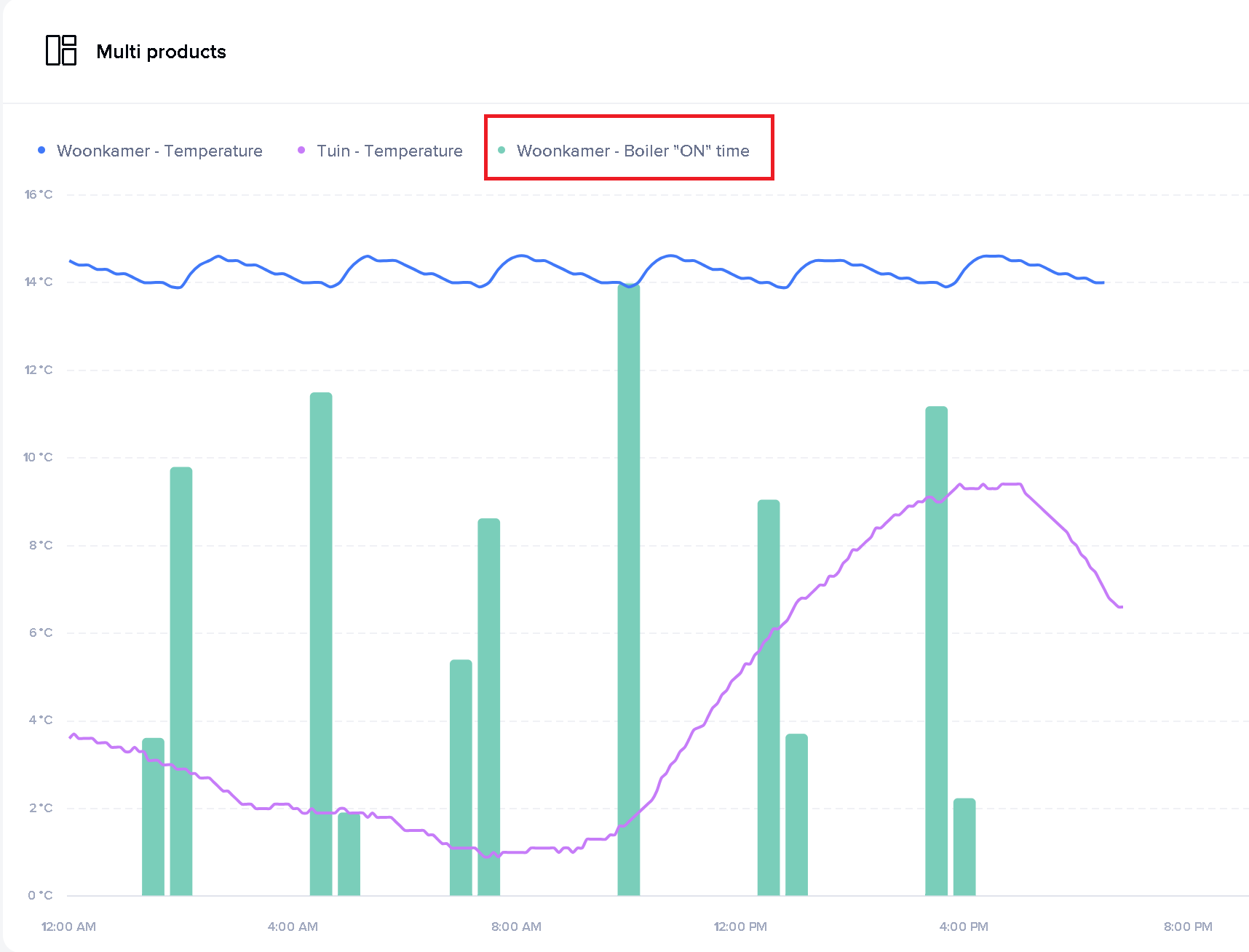

The boiler on/off signal is shown as an icon on the Netatmo display and available in the app and web interface from Netatmo (see screenshot), so it is a pity that it is not available in the official Homey app for Netatmo.
That said, I found there is an alternative Homey app for Netatmo: Bticino/Legrand/Netatmo App voor Homey | Homey.
Maybe you can have a look at that app?
I think this is a great advice! I was also looking for a solution, this app shows you when the boiler (thermostat) is heating or not!
