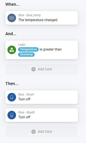

If you need to test a temperature or other value then you need a logic card. Not intuitive, but it is there.
You don’t need a logic crad if you test against a hard value, as Peter_Kawa did above, do you? But actually I want to test against a logic card value, but take the simplest hard value first. As long as that don’t work, putting the value in a logic card will not help, or…?
To Peter-Kawa, nice, as simple as I have done, but the “then” (or “als”) statement never gets a hit.
It works, but you’ll have to realize it triggers ONE time if temp is below X degrees
The next time it triggers, the temp should have been above X degrees first.
It’s like how a thermostat works.
Logic cards are not only used for testing against variables, you use them also also when testing a device attribute against hard values.
The test @Peter_Kawa used also works just fine and you do not need a logic card for that. But it is different in the sense that it only triggers when you go from higher to lower values (e.g. from 15 to 14). Compare that to the one using logic: if the temperature changes (aqara) and the temperature is less than 15 (logic) then …. That one for example also triggers when the temperature changes from 12 to 13.
Performance wise It does not matter that much in which order you test values. But it may matter that the example with the logic card triggers way more often and therefore may perform actions a lot more times.

The flow is exactly like Peter_Kawa’s, but I think I must test a bit more carefully based what Edwin says. Thanks so far.
And based on what Peter says.
Thanks, Edwin. Obviously a more robust programming, it seems to work now.
