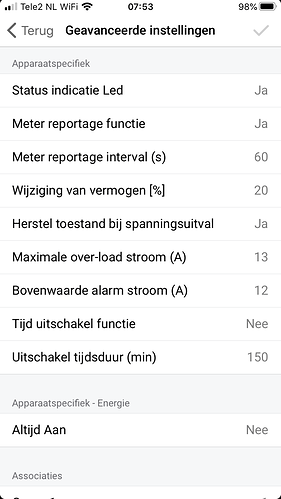

I have the latest version of homey and the neo app.
Now my plugs started working again, but I only get the report of how many volts.
See the screenshot:
How is that possible? Because it updates every minute, but the current stays zero when my lamp is turned on.
Help
Is it a LED?
Because I experience only reporting above 5 watt or so
It is led indeed.
I will try it with the vacuum cleaner hehe :stuck_out_tongue:
Thanks! Problem solved :wink:
