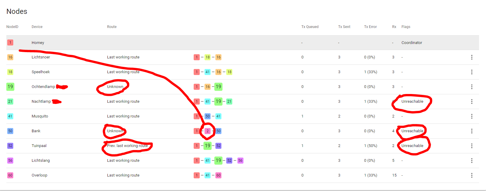

Hi all,
Strange Z-wave plus behavior here again.
  1. The route the wall-plugs take is not logical (looking at the situations in my house). For example the device “Lichtslang” really takes a detour. Why doesn’t it connect to the nearest wallplug and routes one after another the shortest route?
  2. Looking at screenshot 1 i have many times that in https://developer.athom.com/tools/zwave the column ROUTE mentions “prev. last working route”. Sometimes it’s there, and then suddenly it’s gone.
  3. Many devices in the column “FLAGS” have UNREACHABLE. In this screenshot only 1 but sometimes i have 5 or 6 UNREACHABLE. When i “test”, “send test frame” or “heal” it sometimes get responsible/reachable. But few minutes later it is UNREACHABLE again. It works very buggie…

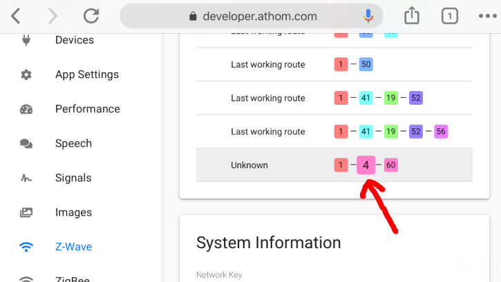

  4. In the 2nd screenshot you can see a NodeID in the routing route with #4 which is very strange as this isn’t an existing node number for long time (however i do reuse that device somewhere else in the house after a wall-plug reset ofcourse) . That has been reset and got a new NodeID number long time ago. I also saw a NodeID with #2 popped up a week ago? Why is that? Any idea?
@PetervdK Any idea? And how are your devices working lately? Can you post a screenshot of your developer area for Z-wave? Many questions, because many stange behaviour…

Screenshot 1
Screenshot 2
