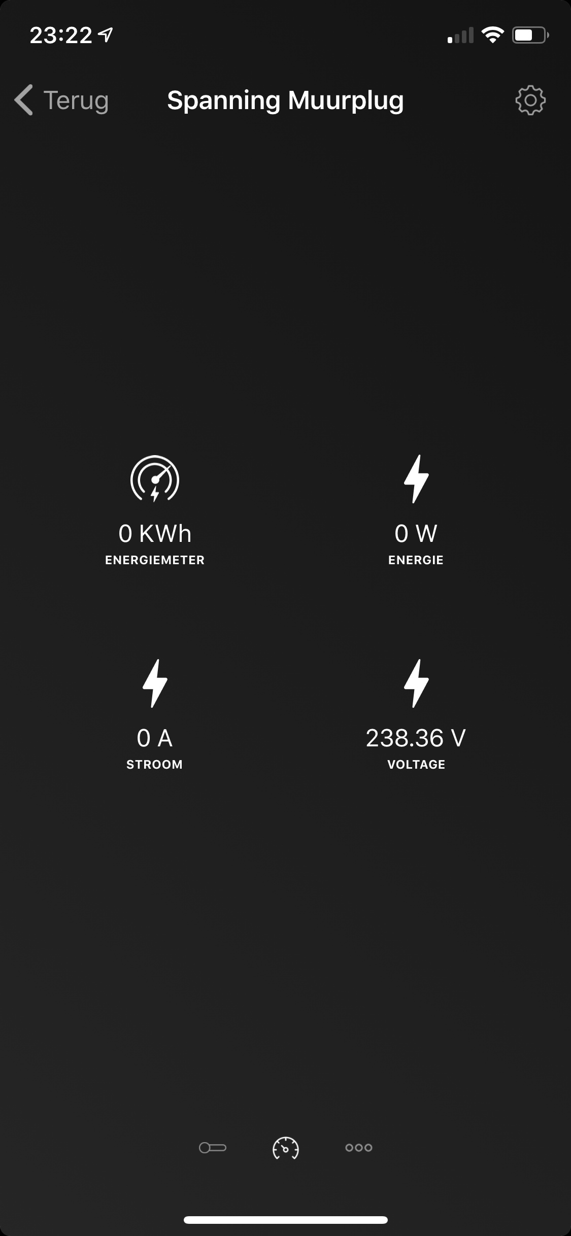

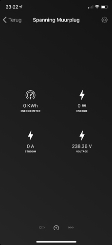

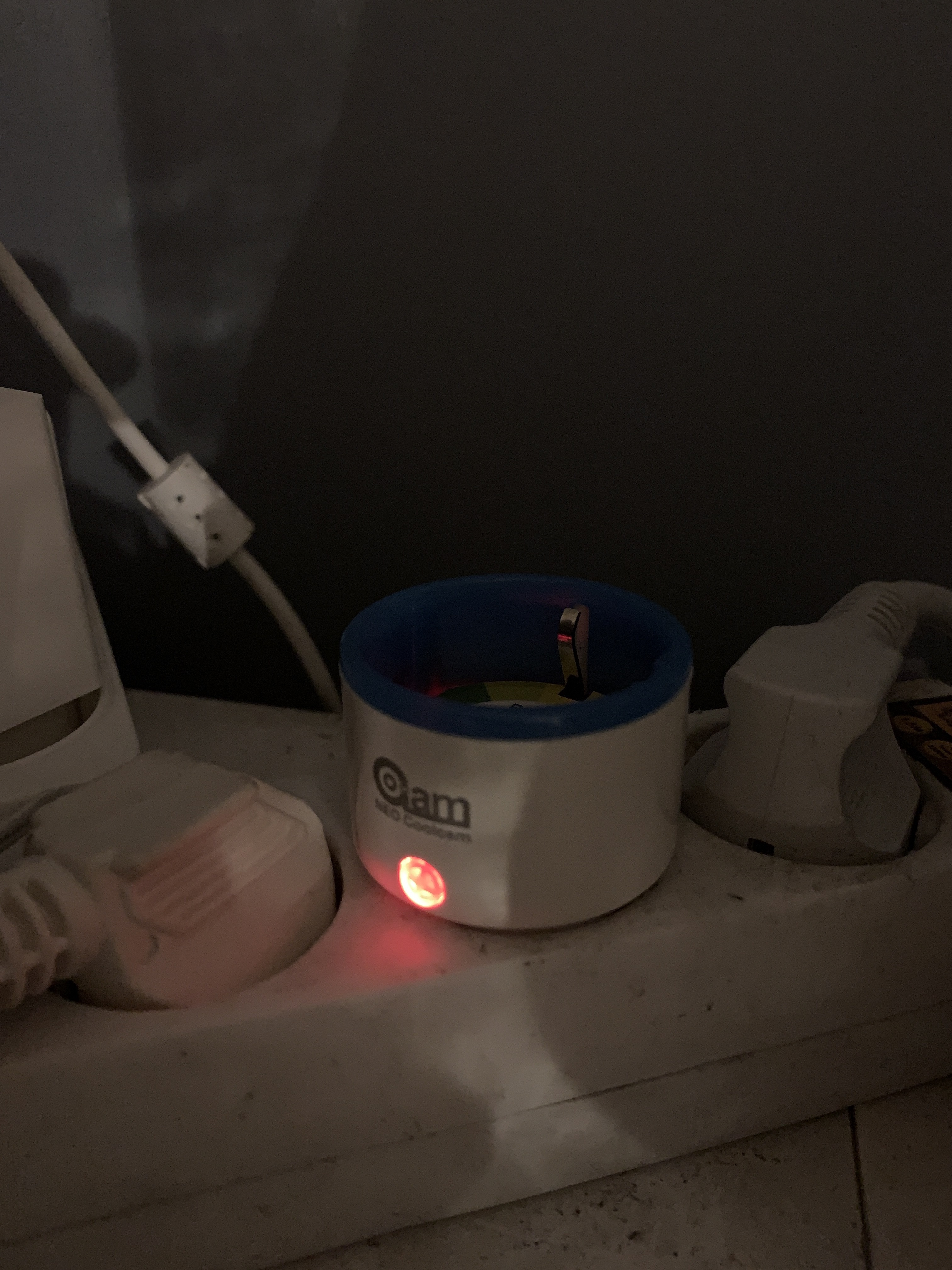

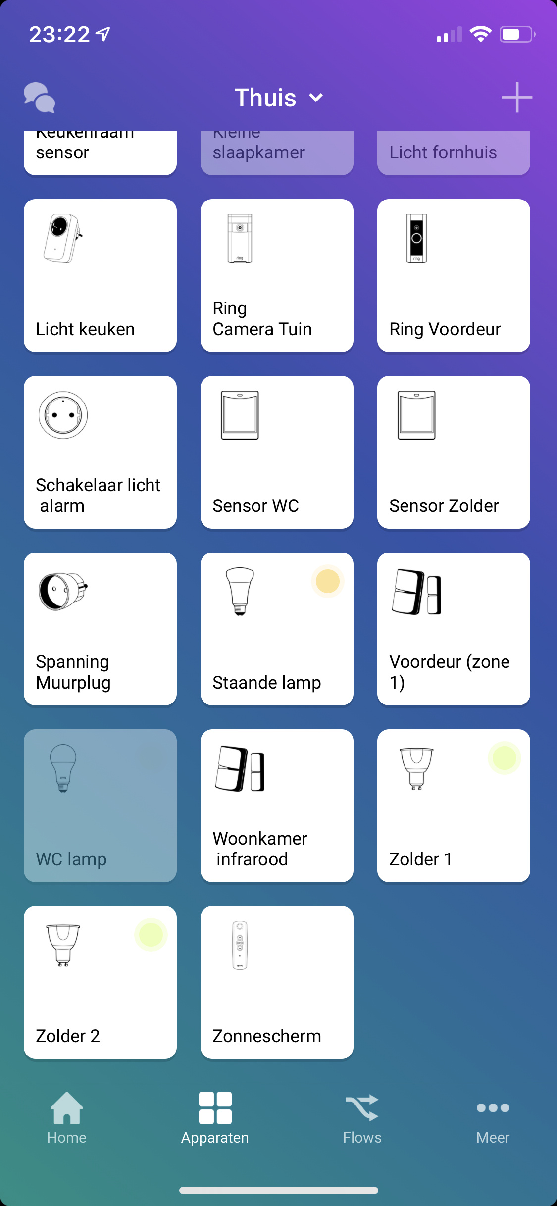

I have installed the power plug. It’s displayed in homey. But there is a red led blinking. I have reset the plug and installed it again and again and again. Still blinking.
Does anyone have a solution?
When I connect something to the plug there is no power. Can’t turn it on with homey either.
Sounds to me like a doa. Since it connects the Z-wave part is OK, but the fact it won;t switch manuallly and the blinking red led must point to some kind of other failure.
Think you better claim it with your seller.
Thanks. I have reported it and got my money back :+1:t2:
:+1: I guess you could keep the defective? Don’t throw it away. Since the Z-wave part is working you can still use it as a repeater somewhere in the house…
