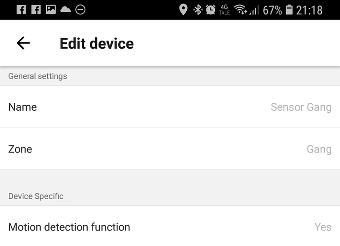

Did u make some changes to the settings?
Maybe post some screenies of the settings?
I have the same issue with ons of my pirs. This pir has the same settings as other pirs and no adjust of the settings is made. In my case I think the pir is somehow broken.
Settings are the same on all mine, shouldnt be any problems there.
