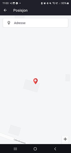

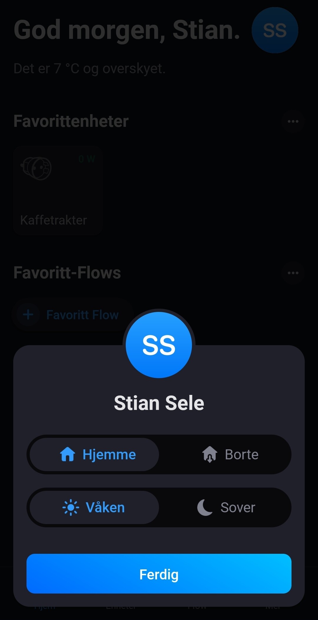

I have checked that im set to home. And the adress is set
Havent figured out how to check time and date.
But location is set to northern europe (live in norway)
