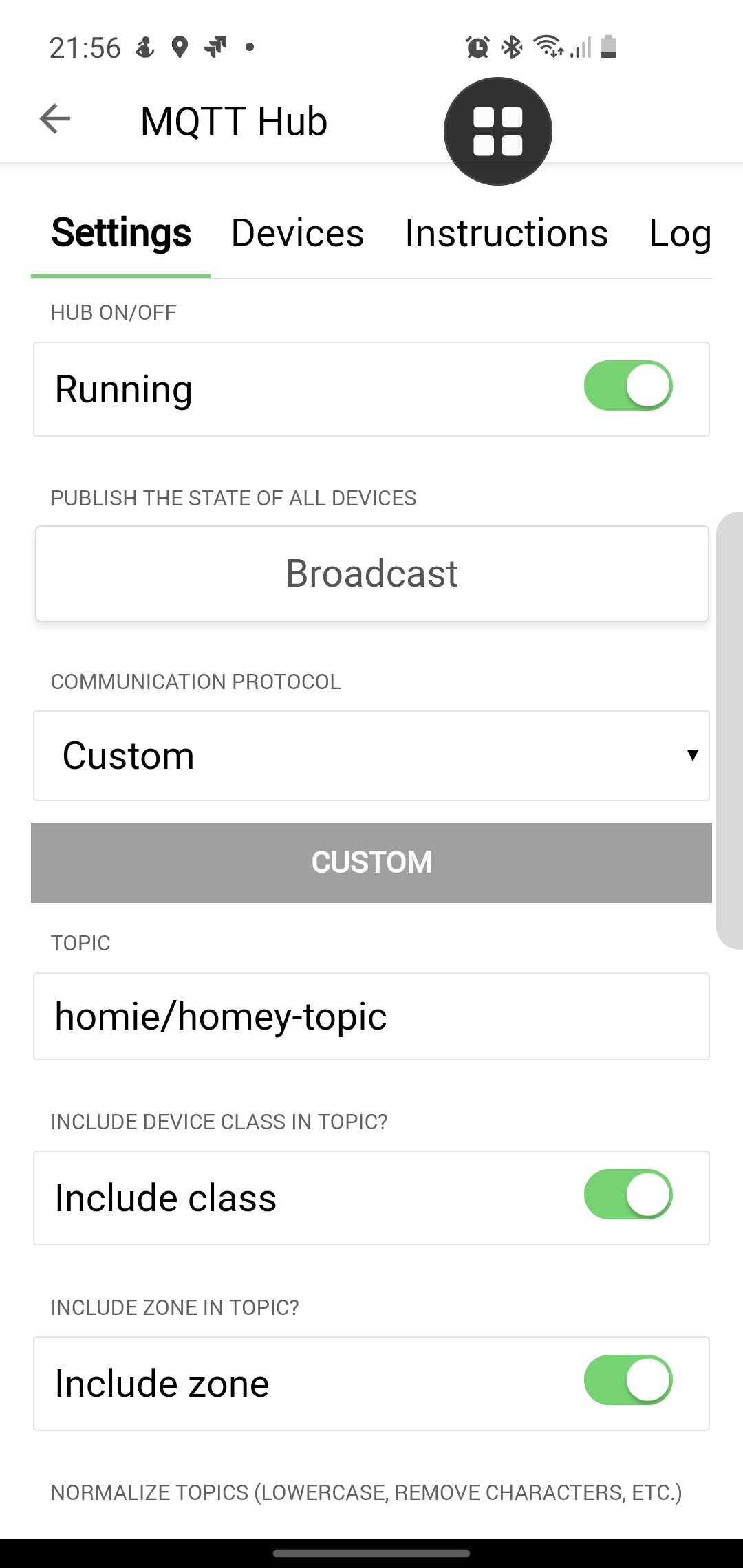

@Robert_Zwetsloot That’s strange. All capabilities are so called ‘value types’ (not objects) as far as I know.
Can je provide a screenshot of your configuration?
For completeness: did you try the test version of the MQTT Client?
@Robert_Zwetsloot Can you report the non-working sensor value from here: Homey Developer
Client v2.4.2
non working value :
Set up:
Version 3.1.6
  • Logging: parse objects to JSON string for debugging puposes
