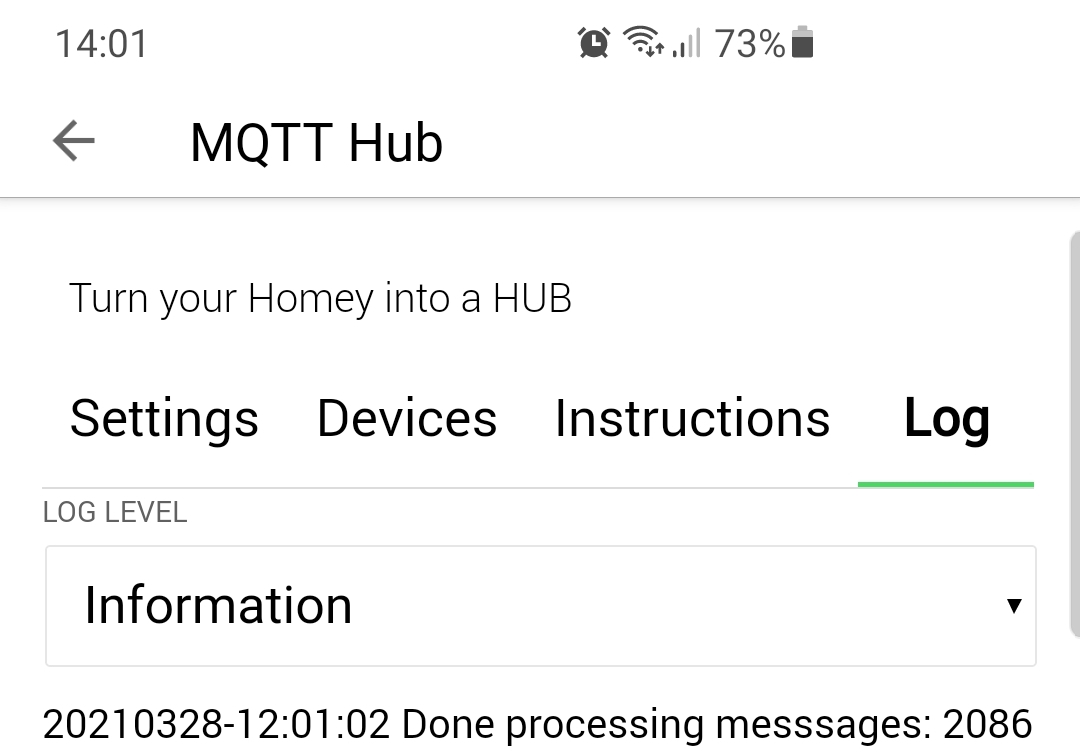

Now that we switched in The Netherlands to summertime last night, time in the log files are off. It report 2 hours earlier.
Same happens in both the Client and Hub logs. This wasn’t the case yesterday, when we were still on wintertime.
I use a MQTT Broker in Docker on my Synology NAS, which has the correct time and timezone (checked).
Installed and switched to the Broker app on Homey for testing purposes, but that gives the same 2 hours (earlier) off.
My Homey is on the correct time and timezone as well (checked).
Not a big problem, but merely a bit confusing when testing / troubleshooting…
Can anyone give me tips, or is this something that should be fixed in (one of?) the MQTT apps?

SDKv3 apps always run in “timezone” UTC. This is a choice that Athom has made that app developers (and users) have to live with (or go through great lengths to work around it).
I won’t :innocent:
Ah, didn’t know. Thanks!
No, I fully understand.
Don’t understand Athom, but I can live with it. :wink:
Thanks guys!
