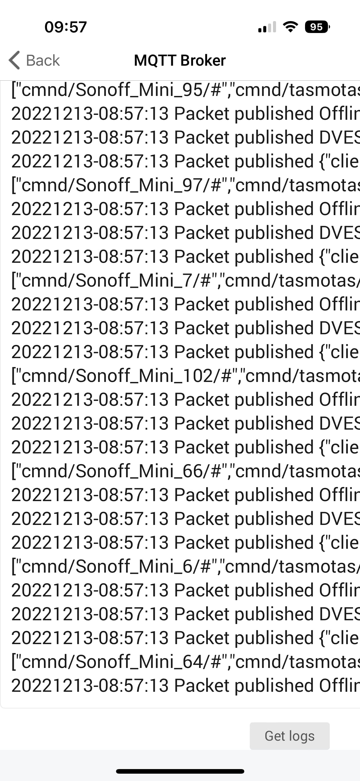

I got the broker to run. I can also connect to it with the MQTT explorere. (The log in the MQTT Broker is all zoomed in some how…)

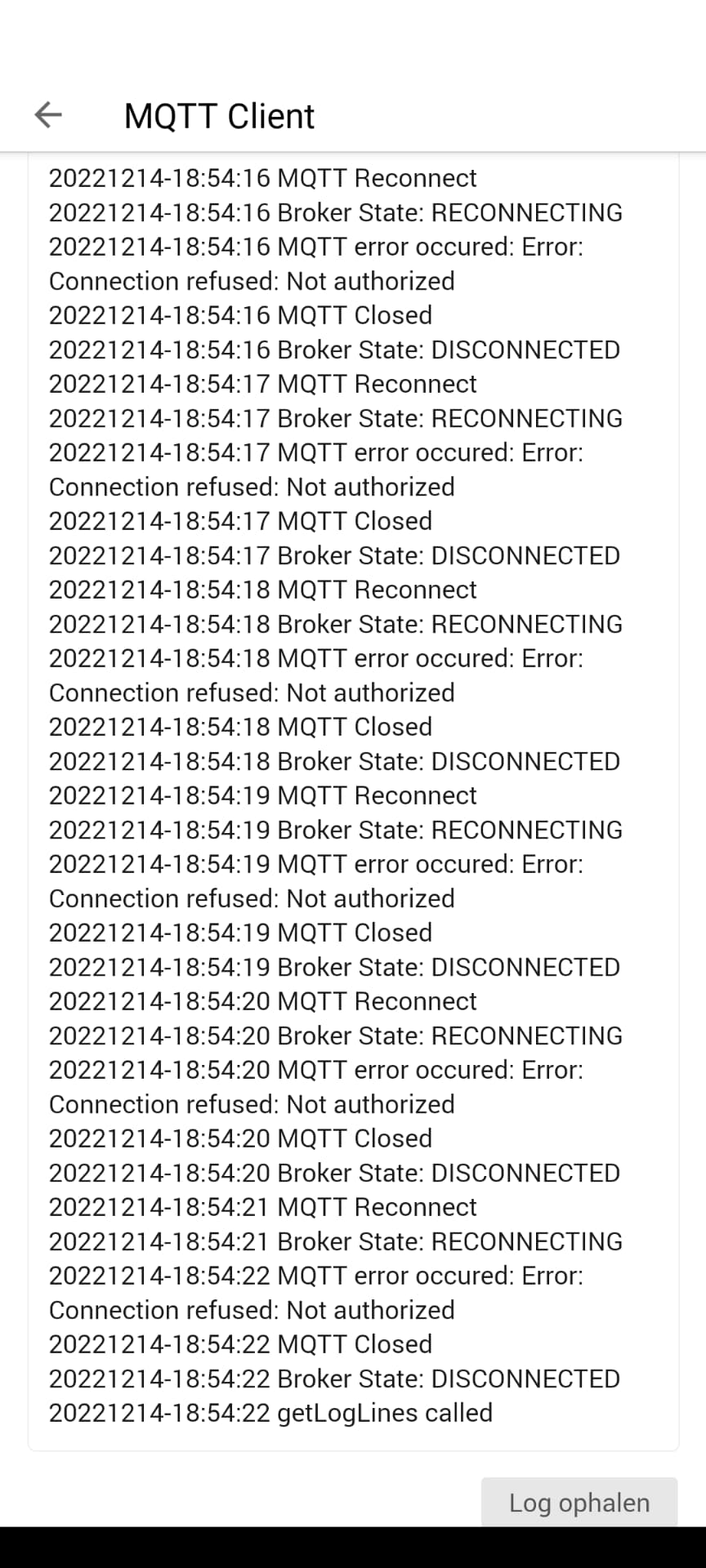

Broker is running, but clients can not connect to it die to not authorized.
Tried all different settings.
Mqtt cliënt also not much luck.
I do see in the broker log all devices trying to connect though.
But no other response.
Mqtt explorer also not able to connect.
