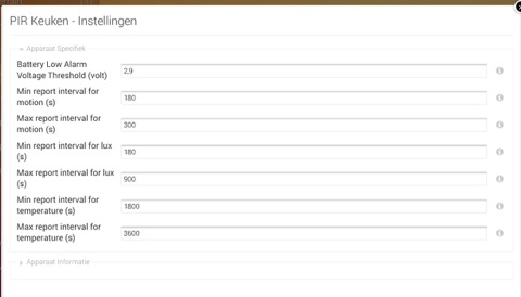

Yes,but it will prevent sending motion triggers every 3sec when you are walking around in front of the motion sensor.
It has a min and max interval.
One is the minimum time it waits before sensing again (continuous motion or lux change), the other is the maximum time it waits before sending (no motion or lux)
I even put my kitchen at 180sec (triggering the radio to stay on at least another 10 min)
