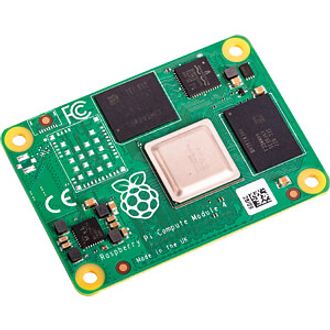

I’m thinking of doing this mod myself. If I get the 8gb CM4 will homey use all of the 8gb (ram) if needed or am I best to just buy the 4gb CM4.
Yes, Homey will fully utilize the memory and delay the swapping. If you have less than ~80 app, you are fine with 4GB though …
But if you already are upgrading I would go for the 8GB to be future proof the next 3-4 years. You’ll never know what functionality/features in the future will be available and will require more memory like the newest matter “app” from Athom which uses 172 MB hete without any devices yet utilized. Watch also the YouTube announcement tomorrow at 16:00 CET from Athom.

Wil one of these 2 work for an upgrade?
or this on:

I hope (expect) so. I’ve ordered the Reichelt one, because it’s cheaper. On it’s way.
The link in the post above yours from @B3rt to Reichelt is a CM40xxxx
So No WiFi,
Doesn’t work… in a Homey Pro (2023)
You’re right. Didn’t follow the links, because I thought to recognize them from my own search. I ordered the 4108032 (with Wifi and way too much eMMC). Planning to only change the board, not repartition.
Yeah I noticed that also, but you have the option to choose With wifi on the page itself, the 8GB version, 8GB or ram and 8GB of storage (which I don’t intent to use) for 92,51 this one:

After upgrading with CM4108032, I immediately used 2.7GB of RAM. Does anyone know what “Other” means? This wasn’t before the upgrade.
You are not the only one: [Modding] Various Homey Pro (Early 2023) Modification suggestions - #169 by danone
Before the upgrade you didn’t have that much memory… Now you have and so it’s taken.
Isn’t that because before the upgrade it is swapping memory and after upgrade it doesn’t have to anymore? That would explain why it is “suddenly” using more memory after upgrade…
“Other” has always (5+ years) been an “app” on my memory overview.
Memory usage on linux is not static; usually apps and software grab what they like, then they’ll use quite more memory; When free RAM becomes sparse, they use less until the absolute needed minimum.
With f.e. 18.5GB of free RAM, the “Other” uses 2GB as you can see:
(But “Homey” uses half the amount, probably because there’s few apps on this particular system)
(Thanks for the screenshot, @Friedhofsblond, I love the massive amounts of RAM & storage :clinking_beer_mugs: )
