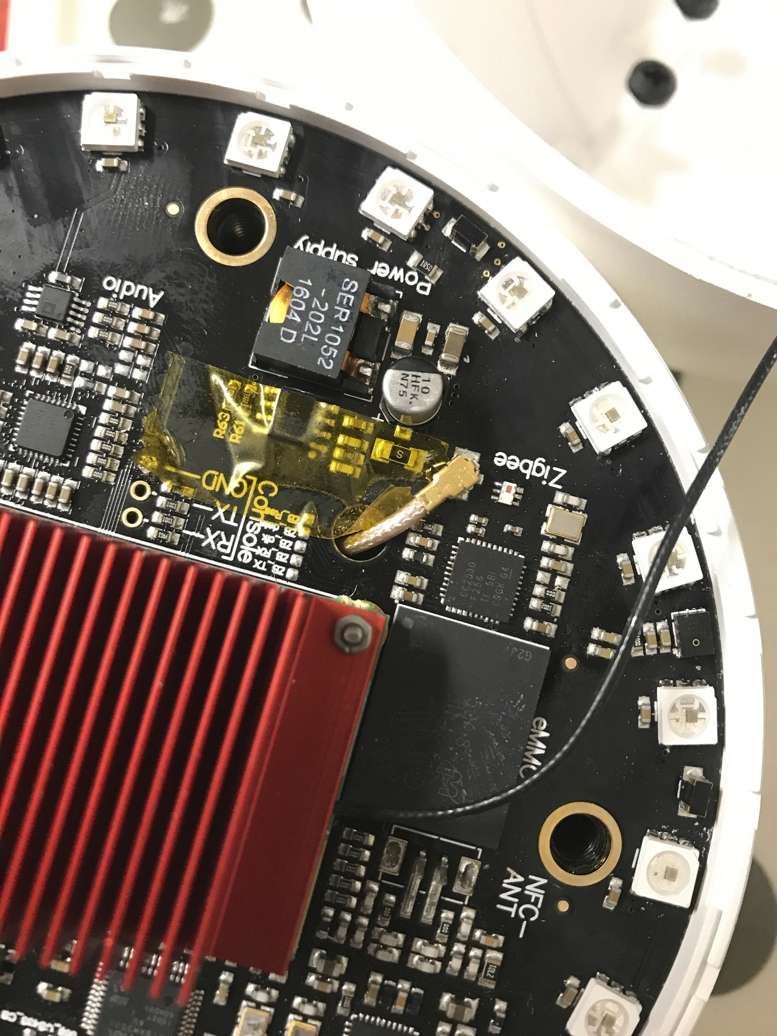

Zigbee:
With the use of an extender, I’ve hidden the 2.4GHz antenna behind the TV cabinet. No change in range.
IMG_2583
Inside also the ZigBee cable is now tidy.

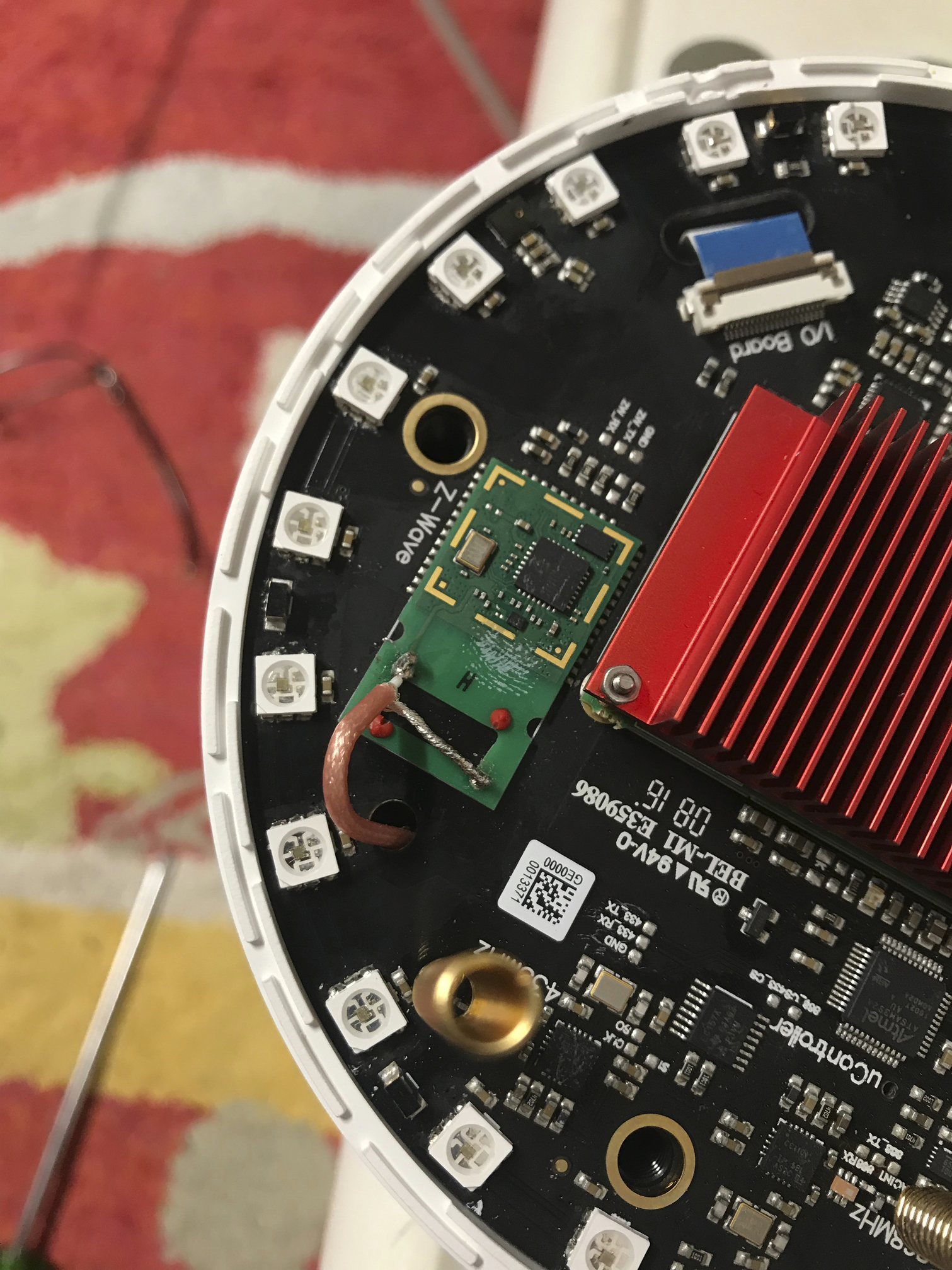

I did try initially to have it hidden behind the tv cabinet, but the z-wave signal was behaving weird, having the mesh changing quite often and lots of devices hopping whereas before all quite stable. Hence, I replaced the long black antenna with a short 1/4 wave antenna and left this one screwed behind Homey.
Interesting, the signal now is even better than before using this small quarter wave antenna. It is the very same antenna that Fibaro Home Center 2 uses.

IMG_2580

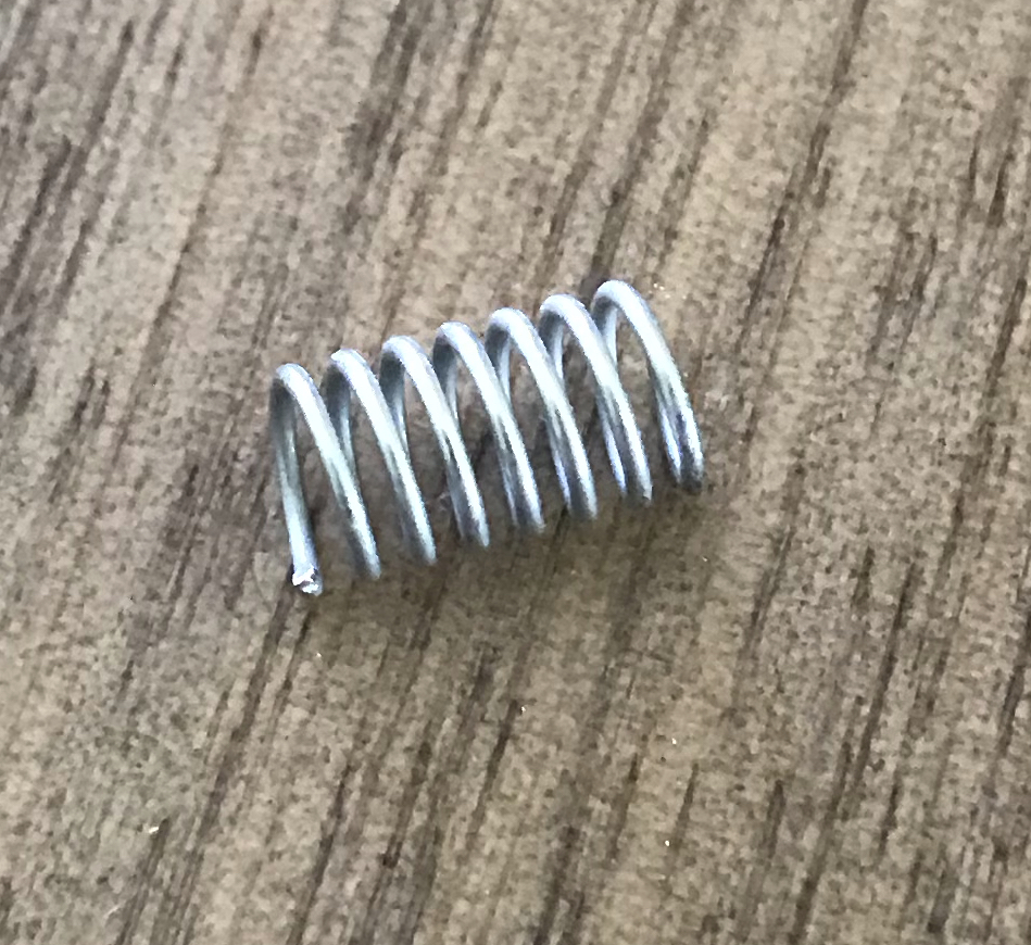

P.S. FOR SALE! Ex-rubbish Homey z-wave internal coil antenna. 0.50 Eurocents, buyer pays freight, packaging, insurance etc
Disclaimer: it will only give you a range of maximum 3m to maybe 5m, but it can be used for things like throw it in your enemy’s eye! :rofl:
Thanks for the update @danone. I am still waiting for the parts to arrive to do the mod. Is the z-wave range much better with the 1/4 wave antenna than the first antenna you had?
I could not see a difference in range when both mounted behind Homey. Just that I wanted a more aesthetically look, and when I did hide the full wave antenna behind the cabinet, it did weird things.
So I left the quarter wave antenna behind Homey, as you can see it is much nicer now.
I see your z-wave antenna is grounded. Do you have any experience what difference it makes between grounded and not grounded?
It’s not grounded, the spot on the PCB where the shield is soldered to is not connected to anything.
Just an anchor point as per few above posts.
Ah okay. I used a bunch of hotglue to keep it in place
