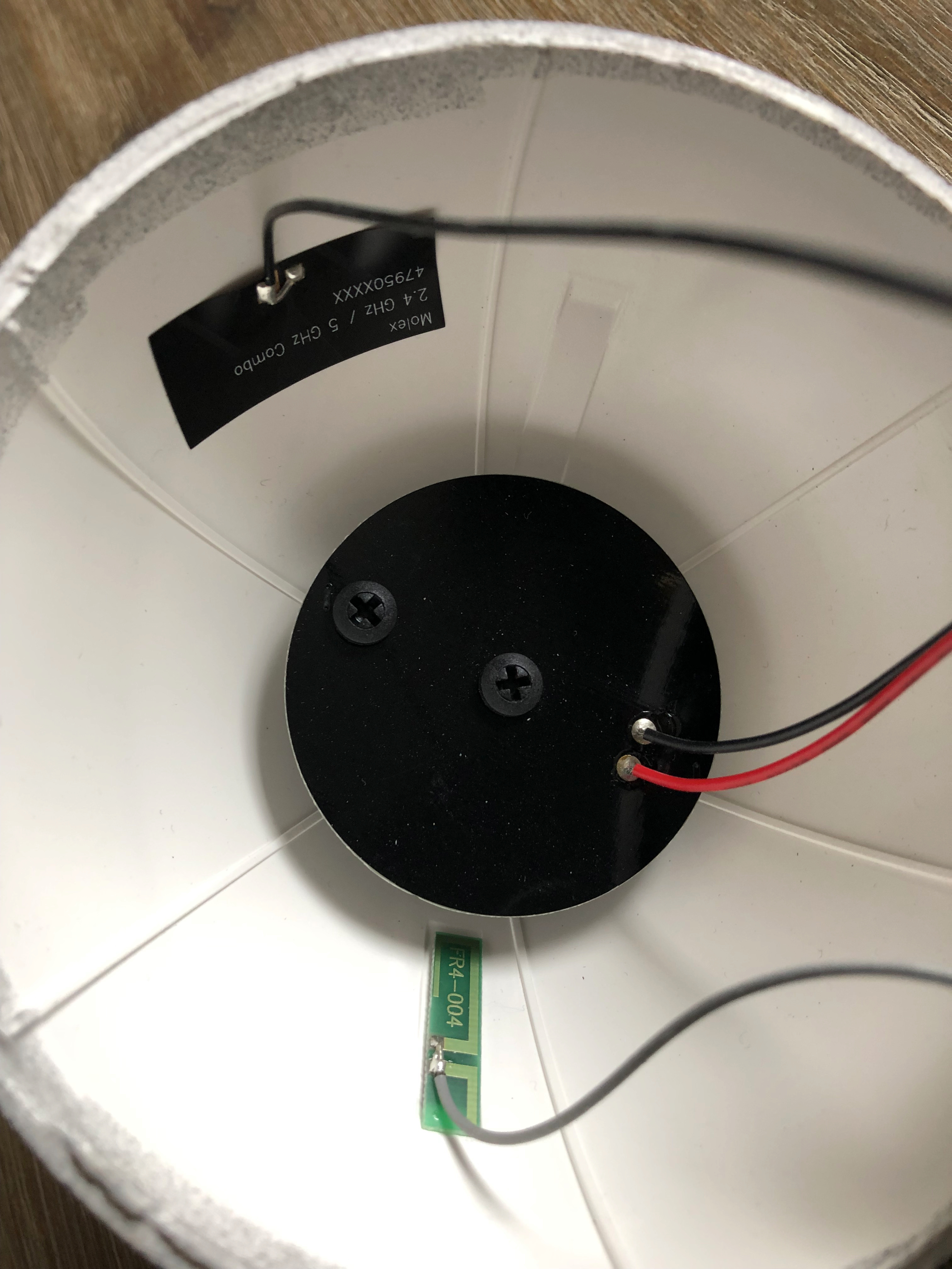

Anyway, I guess you are looking into fitting an antenna.

I see you plan to use an LNA.
Let us know please how it works for you.
Yes! Any advice on where it is best to grab the 5V?
If you unscrew the four plastic screws and lift up the PCB (careful it could be a bit stuck in place) then you should see under the 5V supply.

That’s funny, your antennas for Zigbee and Wifi are the same, mine are different types
(It’s still on 1.5.13 so I can’t see a homeyModelName, but it’s one from the first batch delivered to Kickstarter Backers)
For now I am only using the Z-Wave antenna without my helper to increase signal strength. That will come next but for today it has to run like this or my lady will kill me for having the smart home inop😂
ZIGBEE will be done soon to but I don’t have the right cable for it

Hey! I’m interested in external antennas for both zigbee, zwave and 433mhz. Zigbee feels kinda straightforward with just switching the contact. But zwave and 433? People doesn’t solder on the shield for zwave, just the core of the cable, correct? Would the same apply to the 433? Just desolder the homey 433 antenna and add the core of the cable to my existing 433 Aurel antenna already on my attic (that today is connected to another smart home bridge that I wanna remove)? And if this is the case, would it be possible to just add the contacts to the outer case of the Homey and then run cable to the attic and put up a bigger 2,4ghz antenna for zigbee and a bigger 868mhz (Sweden) antenna for Zwave and have them all coexist up there?

Yes desolder the antenna and that’s it.
I didn’t attach the ground of the antenna
