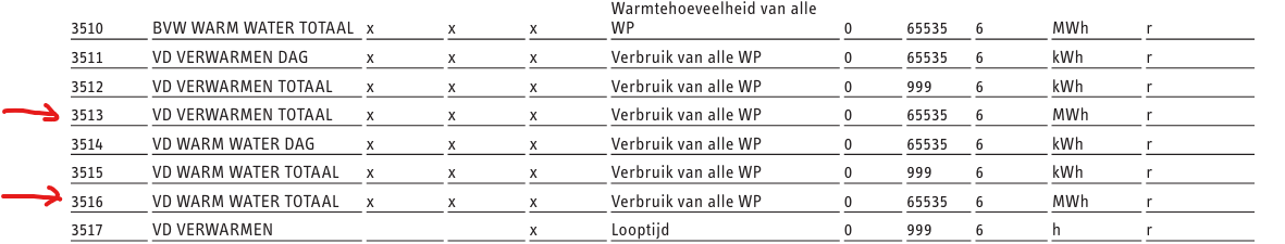

I have installed the app and it works great. I played around with a modbus connection to the ISG some time ago and I have noticed some minor issues in the data. The total energy usage for heating and warm water are missing the mWh component.
You need to add the mWh component x1000 to the kWh component to get the total usage. You can see the modbus registers below. I guess they thought it was easier to split it up in 2 registers instead of using a float.

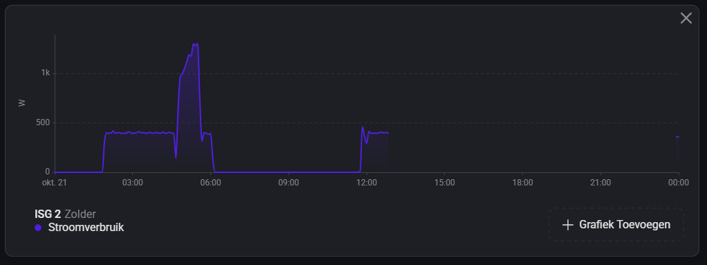

Power Consumption
The ISG does not provide real-time power consumption information, only daily and total energy consumption are available. To make things worse, this data is only partially accessible via the Modbus interface. Unfortunately, with a standard ISG, power consumption information will not be available in the Homey app.
For the tech diehards, it is possible to add the missing data fields to the Modbus interface. I will support these modifications, as I believe this is vital information. With these changes the power consumption, although still an approximation, can be made available:
