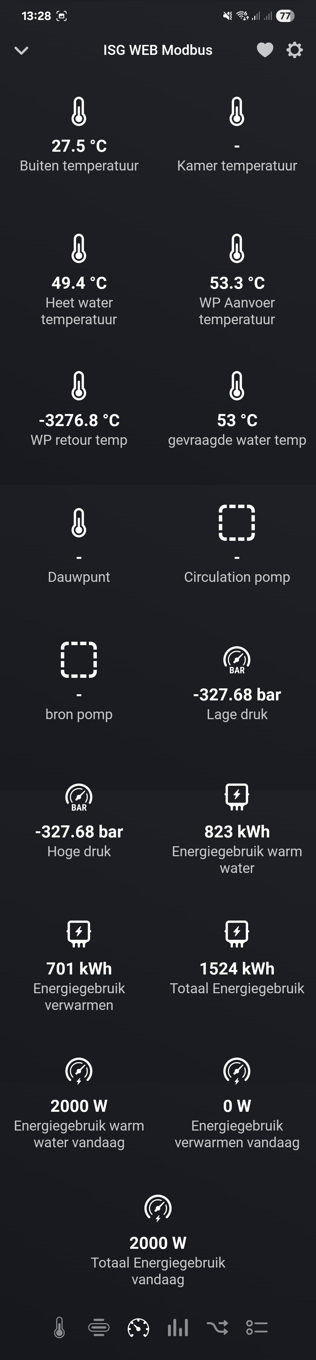

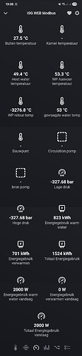

I don’t know if this is the best place to provide you with some feedback, or that you would like to open your own [APP] topic for it, but here is some anyway:
  1. I don’t seem to receive all values from my heatpump. As you can see in the attached screenshot, I mis the ‘Kamer temperatuur’ value for instance.
    Other values that I haven’t received yet are ‘Dauwpunt’, ‘bron pomp’ and ‘Circulation pomp’. But these might be dependant on the heating, which I currently do not use in summer?
  2. The ‘WP retour temp’ field is showing a value for which I think the decimals are not correct.
  3. I’m keen to learn more about what the different values show, so I can think of ways how to use them. Is there some description of these somewhere?
  4. I’m very interested in the use cases and flows you (or the community) already have created! Maybe we can share these somewhere?
