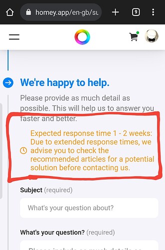

I have pleaded Homey Support to help me tonight (I created a support case 6 days ago regarding the 2 backup services without a reply).
You missed this hidden info?
I don’t get it yet… You just subscribed to the backup service, but now you think it messed up your backup?
What backup is the latter, how many backup systems you have, and how could they influence eachother?
What does this page show?
