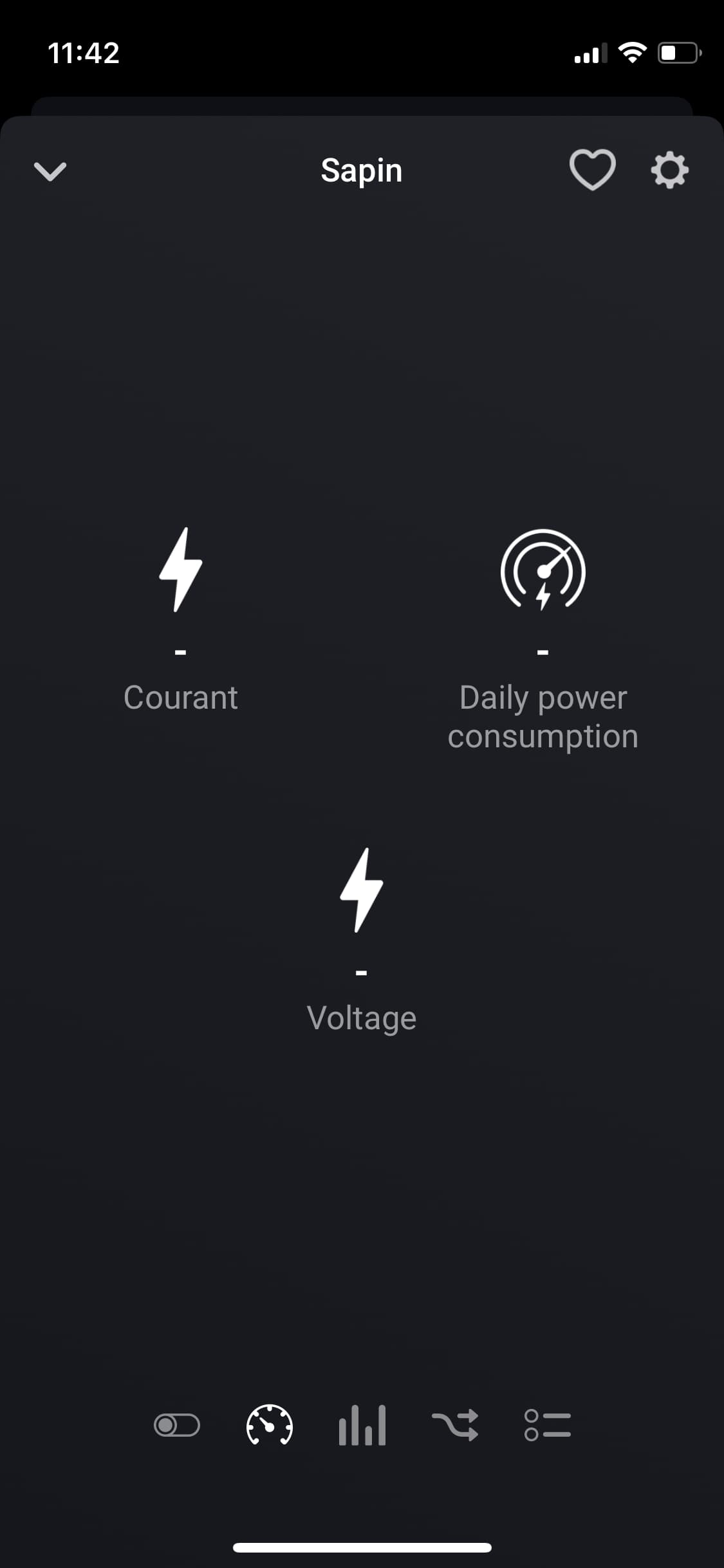

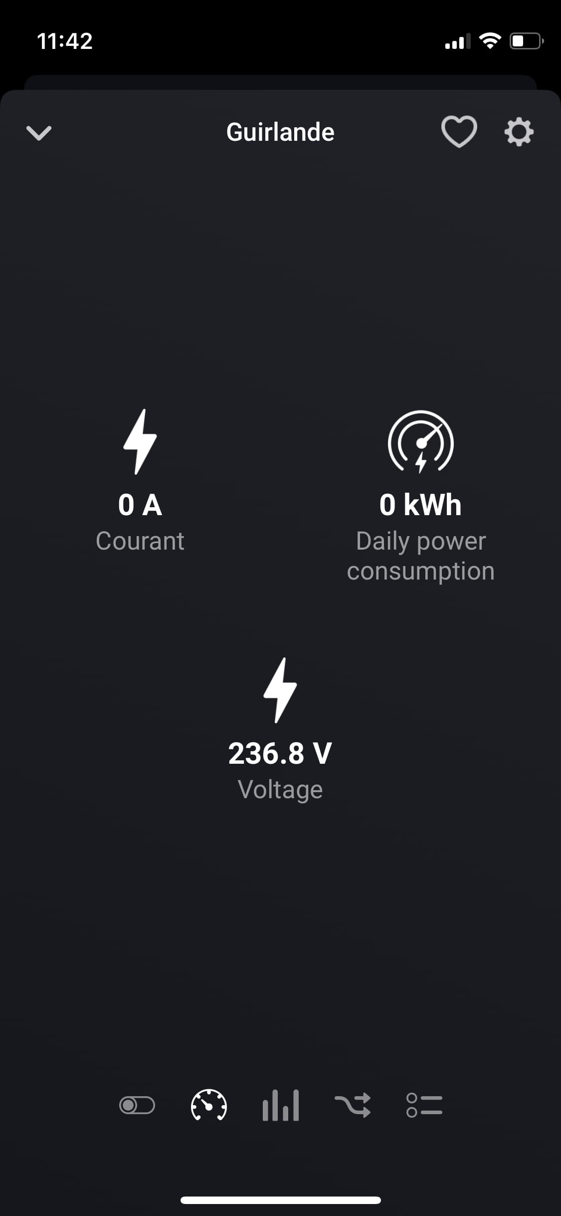

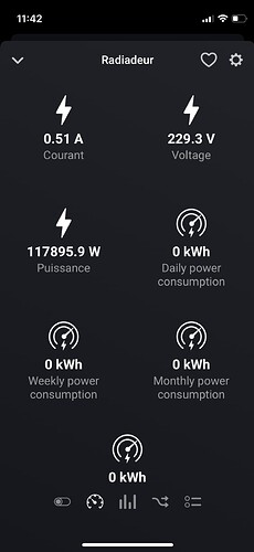

I’ve tried the test version app. Three plugs and three different results :o
no info at all
infos but always “0”
infos but wrong info (it’s not 117895w but 1178,9w !)
(informations in Meross app are ok !)

I also have issue 3 where the decimal point is in the wrong place where 0.58w in the Meross App shows as 58.3w in Homey
