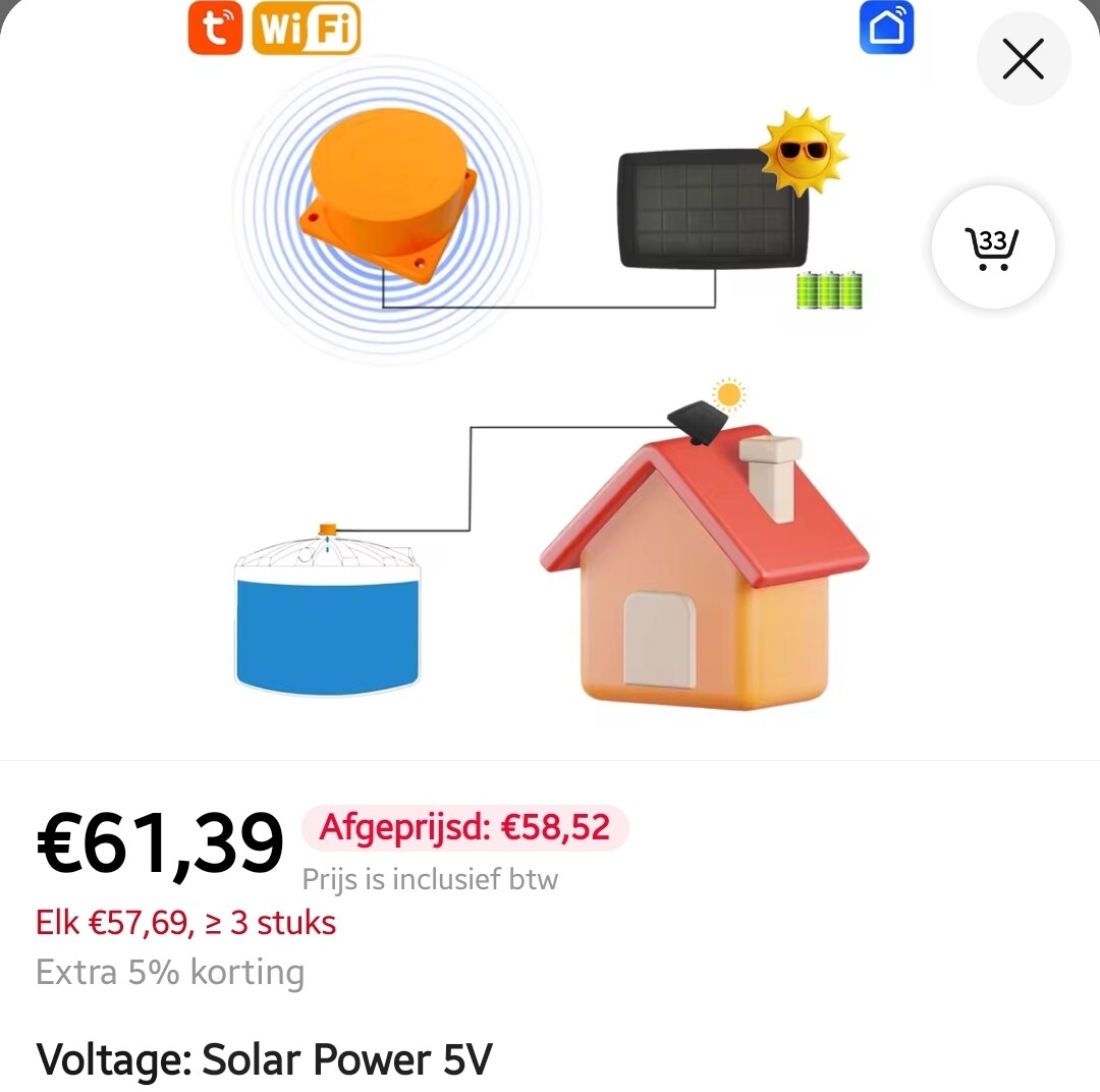

https://a.aliexpress.com/_msqBK03
(Only it’s cloud dependent)
You can use this with the phone app Tuya Smart, combined with the Homey app Tuya Cloud community, by using the workaround called “RAW Commands”.
It’s all in here:
