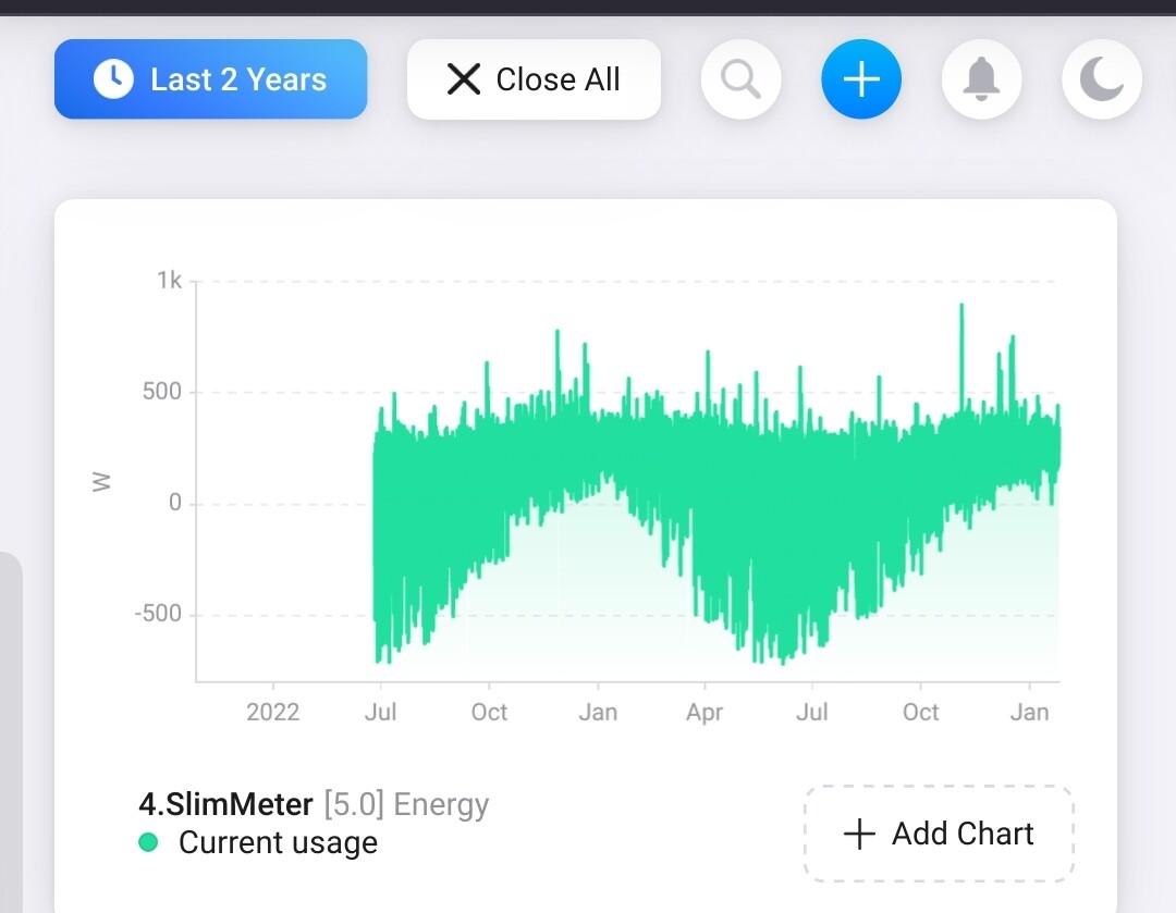

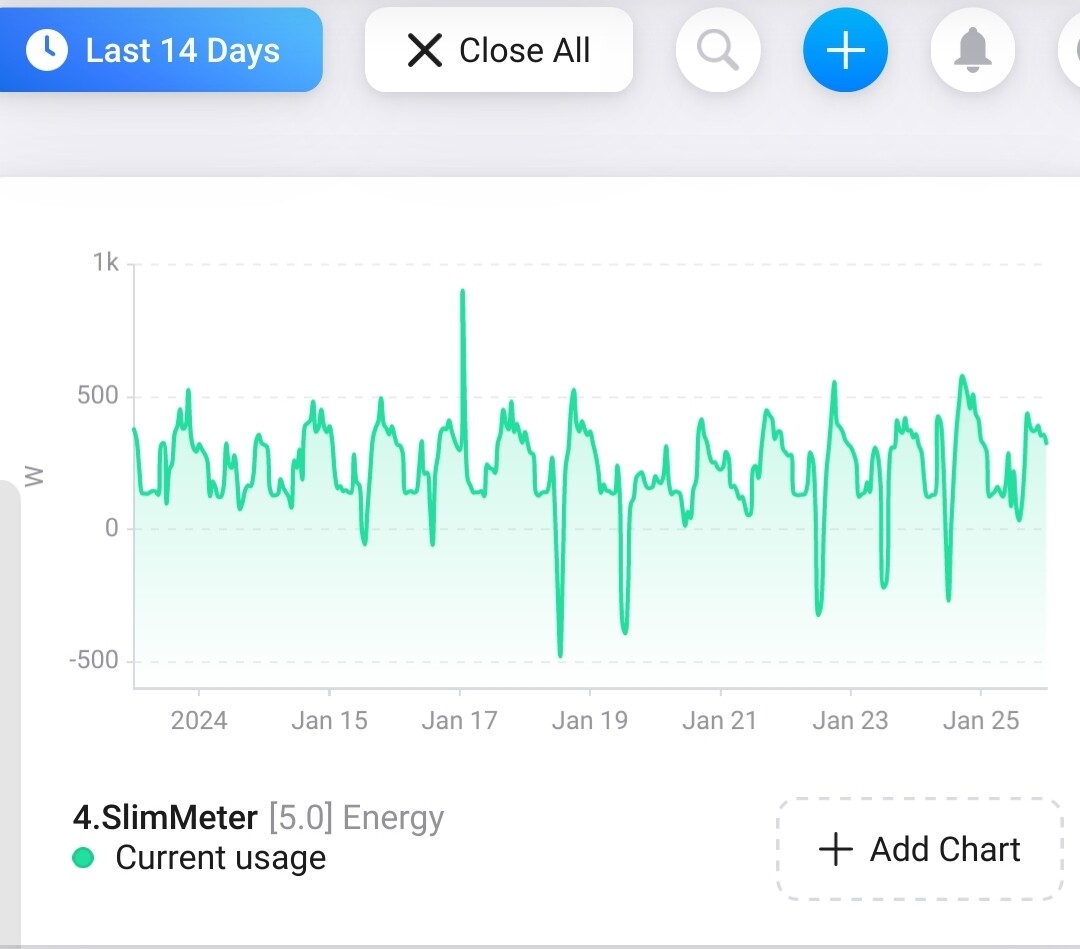

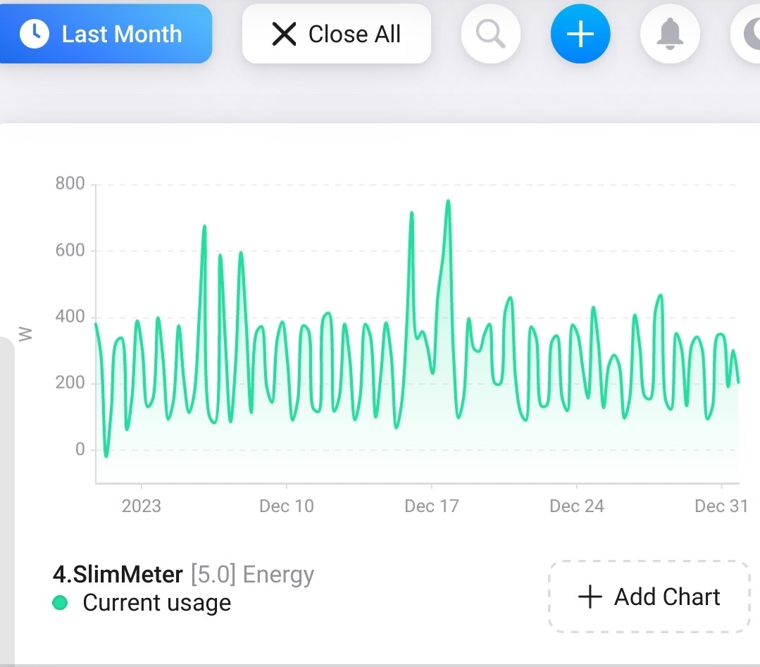

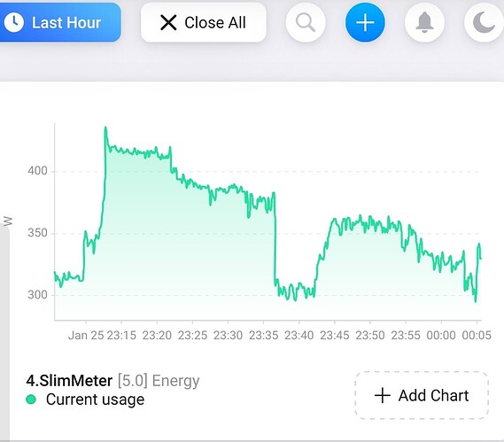

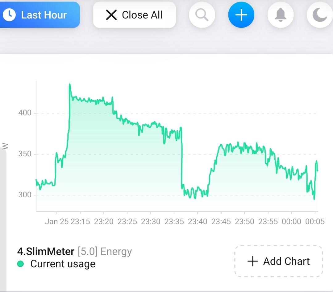

Yeah data gets summarized very quickly, the used datapoints get fewer and fewer back in time.
These graphs are from a P1 with updates every second:

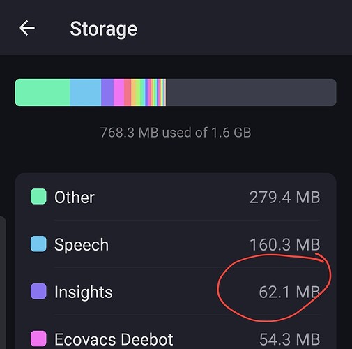

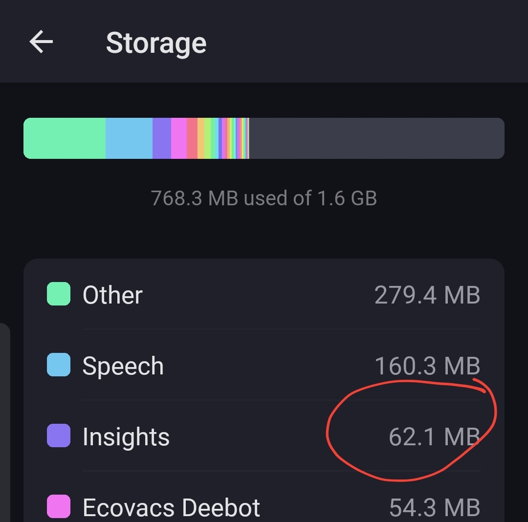

Total size of all of my insights:
Okay, thanks for the insight of your insight :wink:
